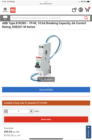

  • I said earlier in the discussion that RCBOs are expensive and not readily available for this consumer unit, based on having done an Internet search.
    You would also need to get the electrician to confirm that available RCBOs are compatible.
    To be honest I don’t think it’s worth spending money on the existing consumer unit trying to partially update it, as Chris Pearson says above replace it completely or as I said swap the existing components around in it to make use of what is already there.
