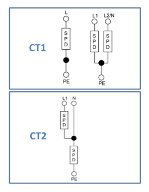

The connection of SPDs using CT1 appears to provide protection only in common mode. That seems be the normal method employed. However, looking at CT2 am I correct in assuming that the clamp voltage would need to be very much less as the protection is provided across the conductors supplying load components? It seems to me that CT1 is for lightning and CT2 more for overvoltages derived from switching???
  • As I see it both CT1 and CT2 limit voltages both between live conductors and between live conductors and Earth - I agree the arrangement is different - so in some circumstances you have two SPDs in series to get a particular effect (L-N clamping in CT1 and L-PE clamping in CT2) but as long as the resulting 'let-through' voltages are still acceptable the protection should still be there. The alternative would be to use three SPD triangle fashion directly between all thee wires (L/N/PE), but that doesn't seem to be necessary.
    For me the difference in usage between CT1 and CT2 is the consideration of the result of the L SPD failing to short circuit - if it's connected L-PE and the short can't cause ADS (e.g. because it's TT and upstream of the first RCD) things can turn nasty - so that's avoided with the CT2 arrangement.

  • I think I am one of those confused folk Mike! So, say we have an arrangement as CT1, each SPD having a clamping voltage of say 1KV, is it reasonable to assume the protection level afforded between the live conductors is 2KV?
  • a guarded yes,
    For CT2, neither line is ever more than Vclamp from PE at the point of surge protection, and at worst L may be going up by 1kV while N is going down so then the L-N difference is indeed  2* Vclamp,  - though just as often they could both see a  jump in same polarity so the LN difference may be small even if both arrestors are clipping relative to PE
    But of course as you move along the cables and away from the surge protector towards the origin of the over-voltage, then  voltage  slopes due to Mr. Ohms law and even more confusingly the effects of  V= L*di/dt  grab you in a rather rate-of-rise time dependent way.
    And V clamp is only that 1kV single figure at the crest of a current pulse with  very particular test waveform, it is not a level at which a flat-top is always guaranteed.
    Mike.

  • The reason I ask about the series arrangement is that the overvoltage withstand requirement, Uw, for equipment as set out in Table 443.2 is for live conductors to earth. In a CT2 connection could the clamp voltage to earth be twice the individual SPD clamp voltage or is the connection to neutral an effective voltage divider?
    So say an overvoltage is in the order of 2KV line to earth. A CT2 method is employed with a 1.5KV SPD between line and neutral and a 1.5KV SPD neutral to earth. Given the earthed neutral, will the line to neutral SPD short?
