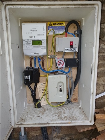

The supply head is in an external meter box, I will be putting an additional box of some sort next to it.

House is on fused connection taken from henley blocks in main meter box, plan to leave this as it is and then run tails from henley blocks to second meter box.
Question is what do I do there to support the 3 connections

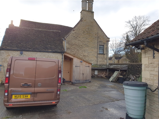

Given that the meter head is actually in an open log store next to the house I am swaying towards everything going inside a metal IP65 enclosure

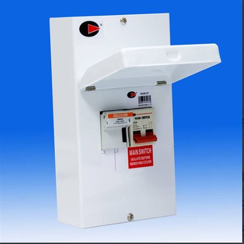

    I now have a full understanding of why fuses are a good idea in the application. But also an appreciation that plastic enclosures for multiple fuses or circuit breakers with high ratings is probably a bad idea. Probably explains why I can't find a plastic enclosure with bus bars capable of taking 16mm cable.

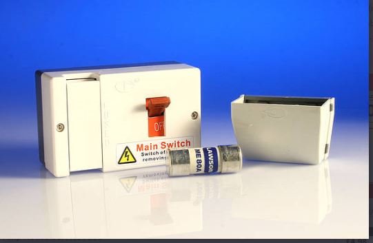

    Given metal enclosures are a bad idea due to open pen issues I am going to need to go down the path of individual fused switches using something like this. With everything contained in a meter box providing plenty of space for heat dissipation.
