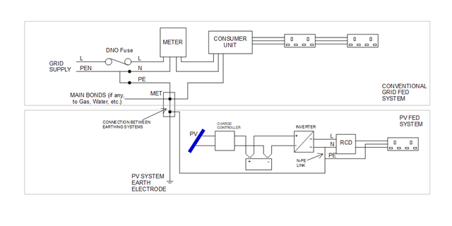

Hello newbie :
Imagine Domestic kitchen Usual array of sockets and under counter appliances
Wish Introduce  Alt solar supply sockets alongside existing grid supply sockets , Thus : User can select alternative ( solar ) supply as opportune arises  at point of use ( battery storage/ inverter system)
Eg plug microwave to alternative socket  as power opportunity ( battery charge is available )
(Alt supply sockets are entirely dedicated from inverter as typical OFF grid system )
Question  Is there  anything in regs preventing this ; Thought: The sockets must be somehow labelled / identified as alt supply  Any ideas to meet regs?
Remark : similar to external generator supply but with NO changeover switches . Outlets are dedicated
thanks Ms Otis
  • thankyou chris     Hoped my diagram explained :One appliance has only one plug ?  So you only have one opportunity to plug it in Grid or Inverter socket  Cant do both  But Both can be live .  Sun or moon   but I do envisage battery storage  solar charged for inverter  Benefit  Direct point of Use : I only have to size the  KWhr system for the max load  Not add up all as with changeover switching    Smaller battery/ inverter . Still fingers crossed for earth system solution  ciao  Ms O
  • Andy  ! OH  Bingo ?  Attach my updated visual in line with andys suggestion .  Andy have you ever done this ? Is this a common dual supply solution ?  All comments welcome please :

  •  Andy have you ever done this ?
    Not exactly - I've had some involvement with UPS systems (for IT server rooms) though, so some of the principles are familiar.
    guess it is expensive to test an earth rod  Would this be required as part of final sign off ?
    If you've got a grid supply, with a bit of care, a rod can be tested using an ordinary loop tester (something every domestic electrician should have). There is a bit of debate about a suitable value - the traditional (BS 7430) advise was a (somewhat arbitrary) 20Ω - which can sometimes be difficult to achieve, but some more modern text books are more flexible and you might get away with something closer to 200Ω for simple setups like this. I think the electrical energy storage systems code of practice covers this.
    Does solar panel mount  system also require earth . ?
    That's probably a "it depends" answer.  A few years ago the answer was "almost certainly not " - as the d.c. was either extra-low-voltage (<50V)  (so no earthing required for shock protection) or if higher voltage was protected by double/reinforced insulation (so again no earthing required) - I gather than the thinking has moved on a bit now (with all sorts of other considerations coming into play, from lightning to EMI to modern transformerless grid-tied inverters that don't necessarily provide separation from a.c. side) so sometimes the answer might now be different. I think it's covered in the PV code of practice, but I don't have the latest version to hand.
    Was figuring on laying both dc and ac cables underground as 10mm for all. 30 + meter distance  Trying to be sure /only want to trench once
    There's a simple method to make sure you dig once - install a duct (I like "twinwall").  A size or two larger than you think you need. You can then draw in additional or replacement cables at a later date.
    d.c. underground (as I hinted earlier) might be a bit of a issue. Not because it's d.c. but because it's usually part of an unearthed system. Normally underground cables need an earthed armour or similar -  the idea being that if they're hit by digging tools and damaged though to a conductor (which is surprisingly easy to do - as I once demonstrated with a steel wire armoured cable and a simple garden fork) - it'll short to earth and trigger off normal 'automatic disconnection of supply' to make it safe. If the system is unearthed that doesn't happen ... which might be a problem. (We have similar problems with d.c. PV cables concealed in walls - and the usual fix of using a 30mA RCD doesn't work either).  In theory an insulating duct with mechanical protection can be used instead of earthed armour, but the same level of safety needs to be achieved - which is difficult to demonstrate given it might have to resist anything from a garden fork to a mole plough to a JCB. There are possibilities, depending on the details (like the actual voltages and methods of shock protection in use) but the details will need working out. Some will require separation from "mains voltage" a.c. cables (So maybe two ducts, at least 6" apart?).
    The "all a.c." grid-tied approach (PV just has a local inverter, battery system has its own charger & inverter locally to itself) does make life a lot easier in these sorts of situations.

  • guys  Can we please focus on the question I came here for:
    forgive my maybe rant : You can regard this proposal as  possible productive new solar harvest solution or Heresy to the status quo:
    The relative merits aside (for now)
    The question remains if I am to give this a real go :
    Can this proposed system ( as attached ) pass muster to be in accord with " the regs"  Which I submit  to the collective wisdom of this forum for their kindly assessment
    In particular  regards to the earth system ( and the earth rod.  Given that all normal protections  are applied to the inverter /battery system. And so ignore
    In other words If I employ a local "sparks" to facilitate connections / test and sign off  Will there be any unforeseen surprises   Contradiction to the regs. Last minute full stop.

    Testing of the earth rod Can a normal IET qualified person do this  Used to be the norm that domestic EV charge points had earth rod . Can I assume that whatever regulations applied to the installation and testing this would be therefore the same for the proposed earth rod here ?   presume I will not need the National Physical Laboratory to come and test it ? Can be done by most electricians
    TNS  Have heard : In general  this DNO supply cable is ageing and breaking up: Its earth connection back to source may no longer be secure So some new recommendation for owners to install this very earth rod for future reliability ? So that implies approval ?  Can I get the DNO to pay for it ? ( LOL)
    Look forward to all guidance any of you may kindly offer .  If its unsafe I will not do it. But do need to assess costs  practicalities to begin
    Other : Th cabling distances are large because  I have made a personal decision  not to have a volatile lithium battery in the house  So its going in the garage at back of the garden  Underground Cabling would be SY semi armoured run in pvc pipe.
    Colder  Ms O
     PDF
  • TNS  Have heard : In general  this DNO supply cable is ageing and breaking up: Its earth connection back to source may no longer be secure So some new recommendation for owners to install this very earth rod for future reliability ? So that implies approval ?
    One option if you lose a TN-S earth is to convert to TT. However, the DNO is more likely to link N and E, which may be underground and not apparent at the intake. It follows that the safest approach is to assume TN-C-S.
