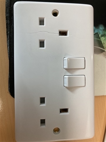

I see BS1363-2 details the ambient temperature range of -5 to 40degC, but what is the physical allowable contact temperature to the faceplate front? i.e the temperature conducted from a plug top or a pluggable PSU etc.
Asking as I've seen a few examples cracking recently (see picture) all examples are cracking vertically from the bottom to the top centered between the line and neutral up towards the earth socket hole.
Some thoughts are this is due to over tightened screws
Thanks in advance for any help on this one.
  • Some people really ram plugs into sockets, if the plugs are not proper BS 1363 as many imports are not, this could easily crack the front which is very hard and brittle.
  • Overheating is often accompanied by yellowing, or indeed blackening of the plastics - this cold crack  effect I have seen where long (vacuum cleaner I think) cables were in use and then they were being pulled tight or tripped over - could it be that ?
    Unless the box behind is over full (too shallow, whatever) and the socket is riding the cables, or the wall is very lumpy, I'd struggle to see how that effect would occur with normal tightening.
    I suppose you could try and  find out how the sockets are used or if there is some killer appliance in use. - funny things can happen sometimes. Overheating in 13A plugs usually follows the line of the fuse.
    As an extreme example this mains supplied food serving cabinet was 'in spec' at 2400watts but the  (still reading low resistance)13A fuse in the plug clearly got quite hot and bothered.  ('it's stopped working' does not capture the full horror, does it?) I suspect the fusholder clips were not in good contact.

  • Is it only a particular brand/model, or have you tried other brands/models and found a similar result?
    Sometimes, particularly if flush-fitted, tightening down on an uneven surface, or if a metal backbox has become somehow distorted.
  • if the plugs are not proper BS 1363 as many imports are not, this could easily crack the front which is very hard and brittle
    If a socket-outlet has undergone type tests to the correct standard, BS 1363-2 does include some very rough treatment tests, and cover 15000 insertions and 15000 withdrawals, by machine, at a rate of 6 insertions and 6 withdrawals per minute, as well as ball pressure test for abnormal heat conditions.
    If a product has not undergone those tests, then it should not be marked in accordance with the standard ... and of course no guarantees as to the performance.
  • Let me add a little more context for this one, this has occurred on sockets where a pluggable wi-fi extender device is used. The wi-fi extender device is also under investigation.
    I've only looked at two sockets so far, the one pictured and a really old (est 30+ year old) one, all pictures seen from reports show a similar crack. thus far there's been about 20 or so reports of this.
    I would be inclined to check the dimensions of the plug-in product against the dimensions of BS 1363-1. For a quick check, Electrical Safety First had a 'plug checker', and perhaps consider its weight etc. against tests in BS 1363-1.

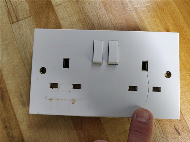

  • I had a similar issue recently.  See attached picture
    The culprit was a Hot Tub.  Which claims it uses 2050W at 20°C
    thus
    2050w / 230v = 8.91
    Now factor in the usage for 8 hours and the plug and socket arrangement starts to warm up.
