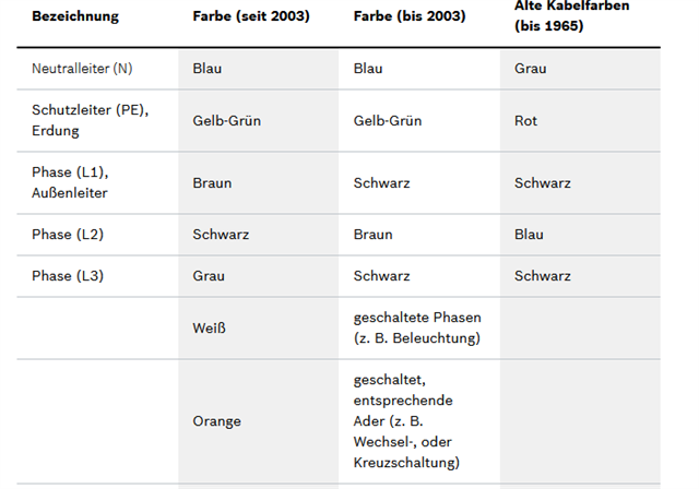

  • I agree, especiall as we cannot see it, though I come from the direction that it is presumably currently functioning as a CPC, (as part of its PEN role) and it is green and yellow. Perhaps one should be adding a blue neutral alongside rather than a new Green yellow earth - but the installation is already a little odd in  having a blue third phase - with that, I'd have expected to see an old German style red earth in that case, though there should not be too much of that left these days, - or a second black, or the modern grey/white.
    Mike.
    PS as the German wiring  colour history is quite different to ours. Bis == until, siet ==since
    rot red, grau grey, Schwarz black , Blau and braun are more or less phonetic.
    Blue is not an official phase colour since 1965 - though like in the UK  there would be some over-run of projects already started.

  • but the installation is already a little odd in  having a blue third phase - with that, I'd have expected to see an old German style red earth in that case
    The OP's top thread said "brown,black,blue being the phase wires and green/yellow" - which almost sounds like they're used fairly modern (harmonized) 4-core cables - I think our 4-coure flexes were brown/black/blue/gy before we got grey introduced with the latest round of harmonization at which point I think they turned brown/black/grey/g-y.
  • but its not actually any of the VDE recognized colour schemes ;-)
    But probably correct.
