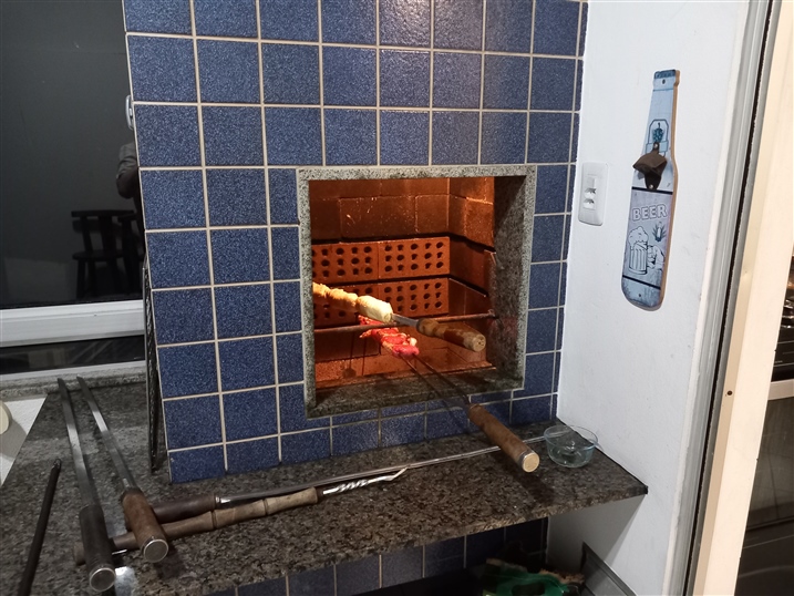

    Mind you this rather fun indoor charcoal fired BBQ has electric light in the chimney shining down  so you can see what you are  cooking, and it is just a metal bodied lamp holder with wiring entering the side of the chimney almost as far up as a normal  arm can easily reach to change the lamp.
    As is evident from the adjacent 2 pin wall socket, its not in the UK - as to do that here that would be far too dangerous.
    It is as good as new after several years apart from being horribly greasy.
    Mike.

  • That looks to me like a Swiss socket on the wall.
  • it does doesn't it, but sadly the wrong continent, as that one is marked as 120V at 20A. In other regions of the same country it would be 220v 16A. Brazil, you've got to like it...
    Mike.
