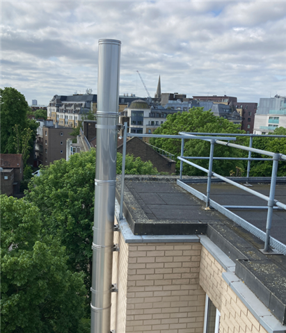

Is it acceptable to use a handrail to interconnect a lightening protection system
At one of our Tower blocks in London we came across this on the roof, I don't know a lot about LPS so was after some advice or any thoughts.

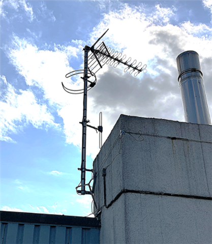

Also as this chimney is higher than the rail wouldn't it need to be connected to the LP system ?

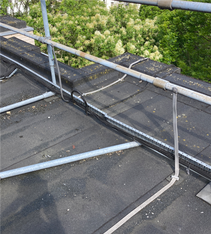

  • It is normal to bond  roof edge rails like that to a lightning system. Less wise to use them as the primary current path!! There should be a no-one on the roof policy in a thunderstorm on a roof like this.

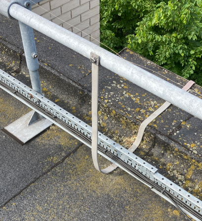

    I'm not too sure what is in the pics, are we seeing the copper ribbons that are interlinks between stuff on the roof or going down to electrodes, or is that section of hand rail the only thing in series between a higher roof top element  and the earth below ? The latter would have me tutting and wondering about the joints in the rails. Chimney, like any antennas and masts, I'd expect to be solidly connected- even if it was via the hand rails.

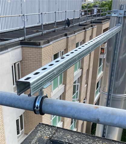

    Thank you for your response, there was another section of building on the roof you can see which was the lift and ventilation rooms.
    So they are using the rail to interconnect the drop from the aerial to the rail then from the rail down to the rod. Each connection at the rail drops down to the rod. So they have used the rail to interconnect all the rods to form a sort of mesh format.
    Appreciate its hard to give a yes or no if its ok or not. I think it warrants further investigation, do you agree?
