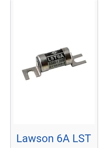

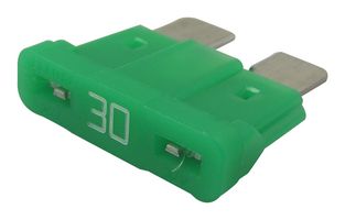

  • Yes they might well be NS types fuses, these are entirely suitable. However the term "blade fuse" is often used in reference to the vehicle fuses.
  • I think we need more info to be sure of what is there - if the OP is still stuck after making another visit, then taking some pictures and sharing them might help inform discussion.
    (Yes I wondered about what was meant by  a 'blade' fuse i n this case , but no-one would use one of these on a mains design - would they ?
    - I assumed a fuse holder with blades for round fuses. like a small one of these..)
