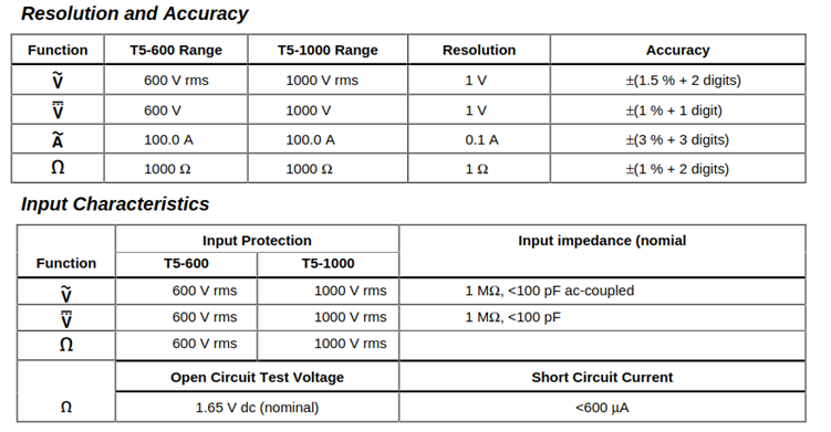

  • how did you verify the volts at each bollard ?,  -I am  thinking that a modern high impedance meter can read voltages that fall away to zero in the presence of any real load - do you have one of those bayonet to meter pins adapters ? - then you can buzz it on ohms with it off, to verify low impedance connections. This picture is the screw in kind but bayonet ones also exist - it may be that there is something not quite making contact behind the lamp holders
    Also your  comment about current implies something odd, I'd expect the working  lamp to draw a lot more than the ones not lighting !! perhaps you can describe how that was tested as well.

  • an amp sounds an awful lot for an LED in a bayonet fitting, I'd expect no more than a few tens of watts, perhaps of order 0.1 amps
    Mind you looking at the spec for that meter, the input impedance is not the highest - about 1 megohm, and the amp range, at 100 amps full scale could be a few hundred mA off, so the meter may be in spec, and at the same time misleading.
    Mike.
