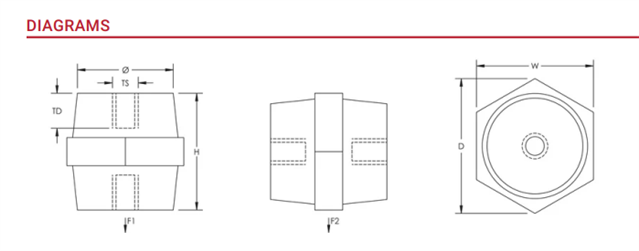

isolators for earth bar or not?
Can someone explain why Erath bar is sitting on an isolators and not directly on the backplate creating solid earthing connection to the whole box/panel/enclosure?
I remember in my old place we bolted in PE bars directly on a backplate but in my present company we use isolators.
Is this normal procedure or only necessary in some circumstances?
Cheers
  • I suspect they're not so much intended to be electrical isolators, so much as physical stand-offs - to give a bit of a gap behind the bar to make it easier to work (getting fingers around the back of the cables for example). On the other hand it possibly makes testing easier if you can remove parallel paths to the chassis easily.
  • Thanks for reply. No, they actually do the job of electrical separators as well not only being a spacers.
    We also use these bobbins/isolators for perimeter earth but it has a reason to test Zs loop impedance but why do they used in regular control panels...same reason? Don't thinks so.
  • I have seen it in the UK for systems with clear/dirty earth segregation. I suspect it is one of those things that is left in as it does no harm, and if you do need it, then it is already there. Saves stocking two sorts of spacer and a small risk of fitting the wrong one.. Then there are odd test and fault situations where you may prefer not to divert large currents through the box.

  • There are TWO very good reasons why earth bars are installed on insulated mountings:
    1. To better-control corrosion. Can be problematic for DC 'protective conductor currents' ('leakage currents') and also with certain frequencies.
    2. For EMC purposes: the 'star point' earthing approach of BS IEC 61000-5-2 helps stop 'earth loops' which become important for higher frequency "noise". If you want the enclosure and/or backplate to be an EMC shield, it's better to individually connect each of the "panels" (front, back, left side, right side, top, bottom), each shelf/backplate, etc.,  through a copper braid or round conductor of between 6 and 16 sq mm. Similarly, with current-using equipment, if you connect cpc's back to the star point (vie the mains distribution units) in a separate way, rather than having "leakage currents" flowing around the cubicle itself, and also through any functional earthing, works best. Also, if CPFE (combined protective and functional earthing) is employed, the star point arrangement helps prevent PE currents flowing through purely FE connections, using the earth bar as the "earth reference" for that.

  • Yes, we do provide Isolators while installing the earth bar and there are mainly a few reasons
    1. It will avoid unintended earth loops within the panel,  When you mount an earth bar directly to a metallic panel or structure without insulation, it may create multiple earth paths unintentionally, which could lead to earth loops, where current flows through unintended grounding paths.
    2. During maintenance or commissioning, sometime we may need to test the continuity or resistance of the earthing system. in case the earth bar is in direct electrical contact with the cabinet, it's difficult to isolate and measure accurately.
    3. This also will help in corrosion prevention in humid area, between earth bar & metal Cabinet.
    4. For Larger voltage panels this could also help Insulation from Fault Currents flowing through metal body, This protects personnel and equipment from electric shock or damage due to unexpected touch voltages.
