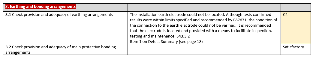

  • We take a fairly stern approach. Example of recent observation on the issue;
  • I agree. The condition of the connection cannot be confirmed, risking undetected deterioration that could undermine the earthing system’s safety. (FI/C2)

    Good points, and taking into account Mapj1's post about testing the Earthing correctly, I'm tending toward a C3/ recommendation to improve. How about buried grid earthing systems?
    There is no way of checking the connection of the cable / strap clamped to the buried grid, as it is a metre below ground, and I don't think anyone would suggest that is a C2 if the testing shows the connection is still good.
    Of course, the typical UK earth spike/rod with clamp on connection is not as good as the bolted on strap on a grid earthing system, but it is not the sort of connection that will come loose if not touched. If ,however, foilage surrounds it, or people can walk across it/wind moves it, then I'd be more inclined to make it a FI, rather than C2. C2 is potentially dangerous, FI , basically, says 'I dont know, so lets look deeper into it'. They both amount to the same thing, a 'failed' EICR, but with a little digging, the connection may be found, and the FI remedied if all is good, whereas the C2 makes it look like there was a fault with the install, where the Inspector did not know, and is guessing.
  • I'd be more inclined to make it a FI, rather than C2. C2 is potentially dangerous, FI , basically, says 'I dont know, so lets look deeper into it'. They both amount to the same thing, a 'failed

    There seems to be something of a consensus that FI is appropriate. Is that not passing the buck?
    Why not a limitation? e.g., "The earth rod was not inspected, but the impedance to earth was within satisfactory limits."
    Model EICR form, page 519 of the Big Brown Book: Section D deals with concealed cables, etc.
    Over the page: "FI - Further investigation required without delay." Carpets and suspended wooden floors with boards could be disturbed, but not the tiled kitchen floor on concrete slabs on concrete beams.
    So, if you cannot investigate, and your private landlord wants a tick in the box, what do you do? Can the "electrical safety standards" be met if the earth rod is concealed?

  • There seems to be something of a consensus that FI is appropriate. Is that not passing the buck?
    I'd be going for C3 if the testing showed the connection is good. The FI is the worst case scenario in my view (OK, it's better than C2, as I dont think it warrants a C2 if it tests well).
    Many people are risk averse, and will always err on the side of caution, but, once you take into account all factors, I fail to see how it could be classed as C2 if the tests are good, so FI should be the worst classification it is given, and on balance, should be a C3. There are many connections that are not accessible,but as you say, a LIM, with a note to explain it, would suffice, though I would still be going for C3, as the EC is more important than an hidden JB in an attic.
  • So some say code 2, others, code 3, others FI others, Lim. I would not argue with any determination made by a competent inspector providing it is justified.
    We don’t have any company policy on codes to be given. The guys are encouraged to carefully consider every issue given the situation and ensure that their deliberations are justified. They sign their name to the report and if you read the rather legalistic declaration above the signatory box, it is evident that the role of the individual inspector carries significant individual responsibility.
    My role is to QA the reports and the processes employed. Generally, if the EICR is for a dwelling, I would encourage reference to BPG 7 without considering it to be chiselled in stone.
    We also need to be mindful that the coding structure set out in Appendix 6 is a rather blunt instrument for communicating a concern to a client.
    Whilst Chapter 65 of 7671 makes reference to the templates in Appendix 6, there is nothing in the chapter that requires inspectors to identify anything other than issues that might give rise to danger.
