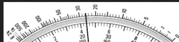

    Very low loop impedance (or very high PSSC readings..)   are a common source of distress when it comes to worrying about things, for example 6000A rated breakers in a CU. In the days of a moving needle instruments, where the high PSSC numbers and infinity were all bunched down at one end of the scale, much like high resistances on the ohms range,
    you sort of knew when you were in deep water as it were because a slight wobble of the head got you from 1000 to several thousand,  while the hundreds were well separated -  the problem of 1 divided by something approaching zero.

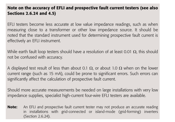

    Given the  ± 2 digits, and resolution of 0.01 Ω, any readings that would come in below about 0.05 Ω (equivalent to about 4.6 kA prospective fault current) are effectively indistinguishable with such an instrument.
    This is the problem with general MFTs used with high prospective fault current supplies.

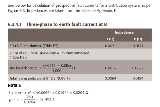

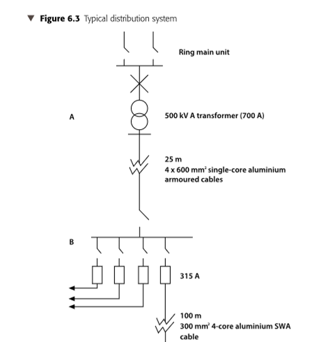

  • An example from the EI Design Guide would suggest the folly of using any of the MFTs. Note the need to determine R and X as separate considerations, something a MFT does not do.
  • And from GN3
