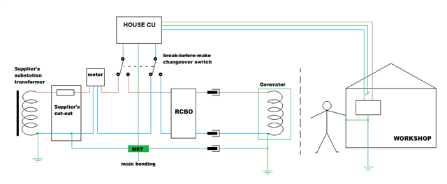

To the nub of my question. I want to install back up generator (7.5kva peak 6.25kva constant)which will be sited out the back of the metal garage( outside garage building not inside)some approx 12m from house. I'll give you my thoughts on what I'm thinking of installation to ensure complete separation from incoming mains supply to remove chance of any back feed especially under fault condition.
1. Install a single phase 32amp incomer socket ( will be supplied from generator in event of outage)to the exterior of house.
2.Wired back to a 20amp double pole rcbo enclosure in distribution cupboard.
3.From rcbo into a manual 3 pole  transfer switch.
4.The network supply wired the manual 3 pole transfer switch then from transfer switch to new distribution board (dB).
5. The generator chassis will be connected to garage earth electrodes when in use.
6.. 3 pole manual transfer switch? My thinking is to switch L. N. and the earth.
My thinking on this: when mains is in use garage supply has isolated earth DB side connected only  as previously discussed to protect cable/circuit going to garage rest of house still using supplier earth path .
When generator supply is used the whole installation house including garage would be effectively TT system this way no chance of back feed to the supplier network including under fault conditions from my/consumer end giving earthing is also switched at the manual transfer switch, i

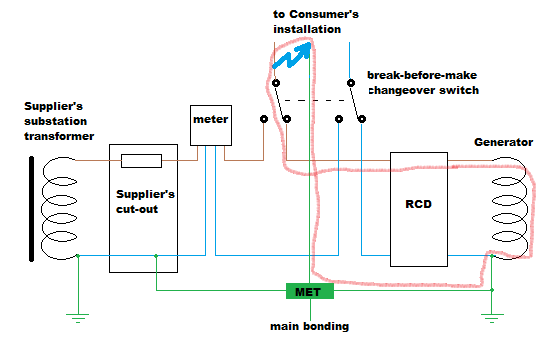

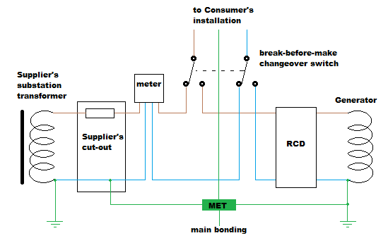

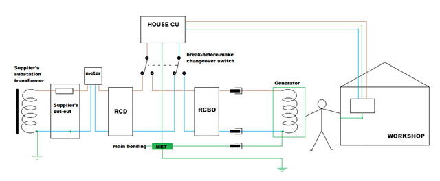

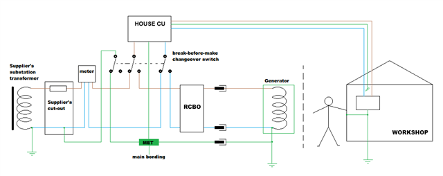

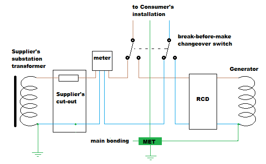

  • If we're to avoid connecting the workshop to PME, I think we've got (at least) 3 options...
    1. Keep the house connected to PME, the workshop TT, and somehow put the generator out of reach of the workshop.
    2. As above, but with some kind of switching to disconnect the DNO's earth when running off the generator (can only work if there are no extraneous-conductive-parts than can import a PME potential from neighbouring properties, and suitable separation from any buried metalwork (and cables) connected to PME).
    3. Just TT the lot (Everything TN-S in off-grid mode, house and workshop on same earthing system all the time) (similar provisos for separation from PME).
    (I've added an up-front RCD on the grid supply for the last one, but it could go after the change-over, or even be omitted if there was double/reinforced insulated all the way to the 1st RCD).
    I suppose you could have a variant of 2 where the PE change-over switch connects the workshop PE to the house MET....
  • 2. As above, but with some kind of switching to disconnect the DNO's earth when running off the generator (can only work if there are no extraneous-conductive-parts than can import a PME potential from neighbouring properties, and suitable separation from any buried metalwork (and cables) connected to PME).
    1. and 3. of your post, I'd support. However, 3. could be costly, perhaps fraught with issues, and may not result in separation from PME (or the relevant issues) ... whilst ticking the boxes in reality, in some installations, could just cost money for no benefit.
    BUT ... 2. I'm really not sure about at all, given G99, and other existing guidance (IET CoP for Electrical Energy Storage Systems, for example) ... and again, might not actually achieve anything if you're still fortuitously connected to PME.
    Not easy.
