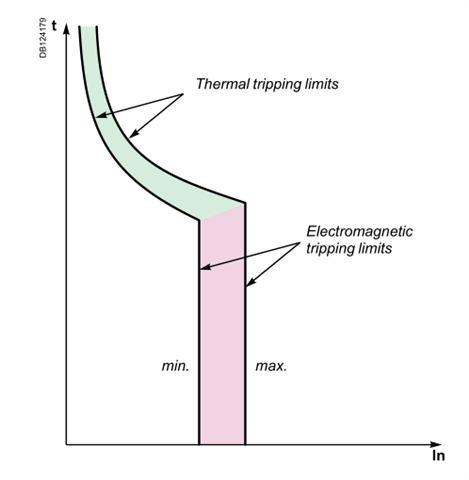

    Modern breakers are not actually  tested in a way that plots a curve either - its actually a very awkward test to do during manufacture and repeated operation tends to 'life' the mechanism, so only a small sample of  go-no-go cases on either side of the lines are tested to give reasonable confidence that each one is good. Samples from the production line may be taken out and tested to death, but not very often.
    The curves only represent  the upper and lower limits of accepted performance but their shape is theoretical and based on the likely physics of operation of a near adiabatic operation from the thermal part when faster than a few seconds, and a vertical take off for the magnetic part.
    If you were to test a real breaker and plot the breaking time results on top of the curves you should expect it to meander between the limits, rather than to follow the curve shape exactly.
    The only thing that is sure is that any test to the left of the left limit should be a 'no-go' and any test to the right of the right limit should be a 'go'. Between the lines, well, it may or may not operate, and somewhere in that grey zone it will make the transition from one to the other.
    Or, continuing the above line of logic, if we are looking at the right hand side as a boundary maximum, it is almost 100 % likely, given a standard distribution curve of products between the two lines (or two arbitrary lines within those lines, that manufacturers will set for their internal quality assurance), that the mcb you have will operate if the instrument reads a maximum as calculated, even it things are "rounded up" by one or two of the last digit ...
