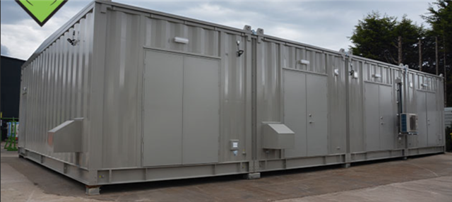

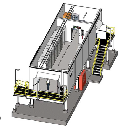

    I am working on switchgear enclosure looks like the ones below but larger containing more modules/rooms.
  • so containerized plant rooms, mostly unmanned, no members of the public ? What is the procedure for any staff who may be there to follow in a fire, How is one detected ? Is there automatic extinguishing What needs to stay on in a fire, what needs to go off ?
    I'm inclined to think that this is one of the cases where the stop the airflow approach is correct, but there ought to be someone designing a whole coherent strategy for fire and other fault conditions - are there batteries for example that need to be kept cool?
    Also, need to consider ventilation required for gases or vapours for relevant equipment, such as batteries and some switchgear, and how they are to be considered in a fire situation, unless there is separate ventilation for these straight into 'sealed' enclosures. See BS EN IEC 62485 series for battery ventilation.
  • Thanks for your reply. It is very simple enclosure. As you have said most of the time unoccupied. There is an emergency walkway provided with running man em. bulkhead light above each exit door. Also fire alarm is fitted with multidetectors and manual call points but we don't do any fire extinguishing systems though. There is no battery room in there neither Atex room. We normally do shutdown for the ventilation system in the event of fire just to not bring any more fresh air but I don't think it is necessary to have similar module to shut DX ACU down in a such a small and unmanned boxes.
