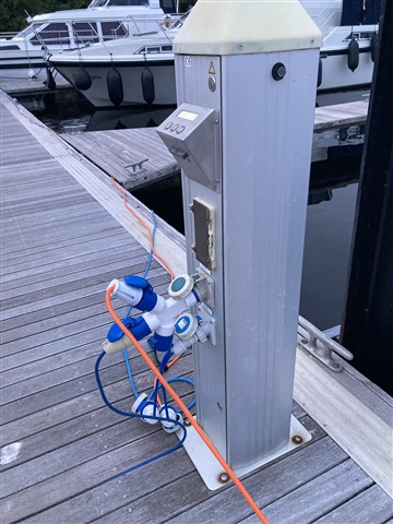

  • Well, I have been on the beautiful Shannon/Erne waterway for 2 weeks and no *** missed me!!! Can’t blame them really! Wish Waterways Ireland had provided a tad more electrical connections!
  • and that photo is load diversity in action. I've always been amazed how many of those 'ray gun' shaped adapters can be cascaded before things actually trip.
