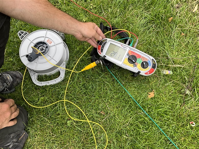

This is the resistance (281 ohms) of the earth electrode connecting star point and frame of a stand alone TPN gen set. It was one of 15 used at a recent outdoor festival. I do appreciate the desire to keep the resistance within the norms usually applied, say around 20 ohms, but I don’t think there is anything in BS7671 that puts numbers on a TN system. I am not looking to debate the merits of such earthing or how this value could be reduced. I guess my question is more concerned about the value of earth resistance that the “T” in TN-S remains legitimate as far as 7671 is concerned. Is it solely related to some value that will ensure RCD protection will operate?

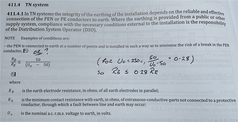

    I don't think so. For conventional L-PE faults it has no baring on the matter (as being a TN system the earth fault loop doesn't include the electrode). For faults to true earth (either directly or via a shock victim) the loop impedance is full of unknowns - the resistance of the soil around the fault/victim (likely to be significant - possibly several kΩ) and in the case of shock the body resistance of the victim as well (usually in the 1kΩ ballpark). Additional protection by 30mA RCD should remain effective in any event - if the loop impedance is too high to trip the RCD the current flow will be so small as to have a minimal shock risk - in a way the situation almost degrades to a separated circuit.

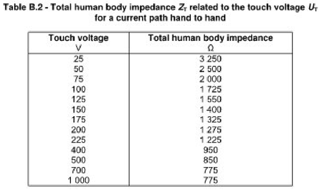

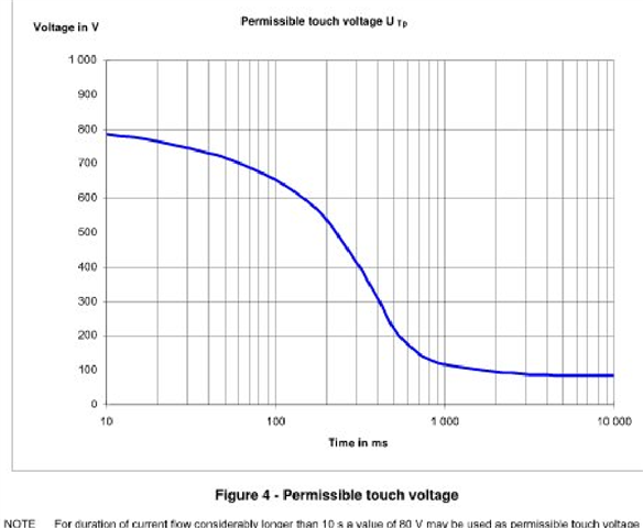

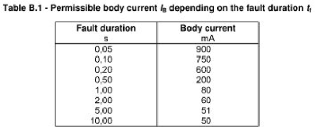

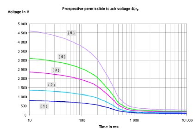

    Comparing with an IT system (for which BS 7671 is similarly bereft of useful numbers or means to calculate them) I'd have guess as Rb being sufficiently high that a any shock current via true earth would be insufficient to cause harm - e.g. 23k Ohms to keep shock currents below 10mA. For lower resistances (and so higher potential shock current) ADS on 1st fault would be needed.

    Enter the RCD, now we can have a 'safe' step voltage of say 50V near the electrode at our largest non disconnected fault current  (30mA/100mA or 300mA depending on RCD) so the resistance to terra-firma can be 1.6k ohms /500 ohms or 160 ohms . Well the 160 ohm case needs real electrodes, but the 30mA one will be happy with a screwdriver or a garden fork in the lawn, and now we credibly are protecting the person with wet feet picking up the severed lead to the hedge trimmer or whatever.
