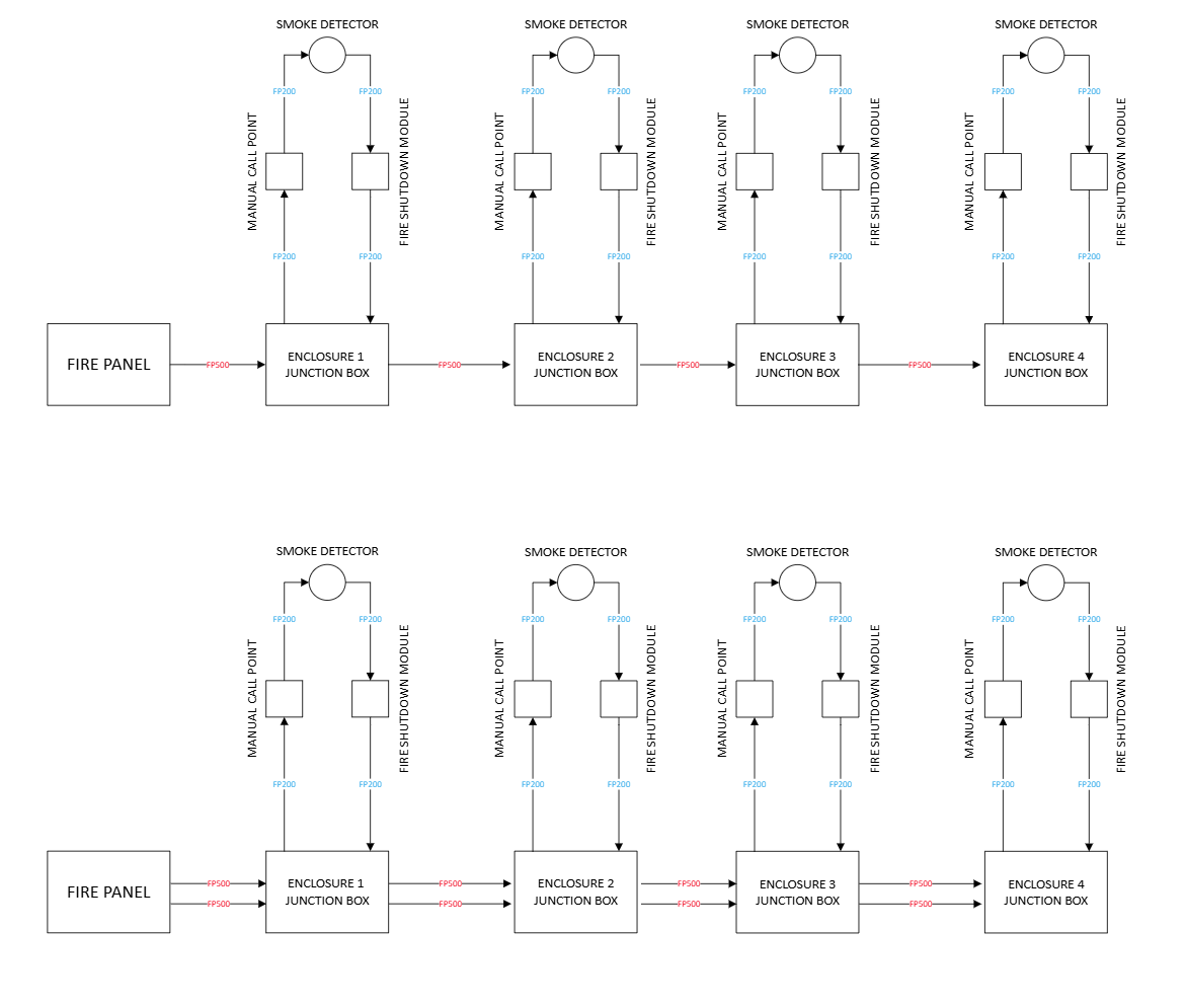

I have a few outdoor switchgear enclosures that are fitted with fire alarm devices. The customer is responsible for providing the fire panel and incoming loop cables for the enclosures that I am designing.
The client suggested using FP500 cable, but as far as I am aware, the internal wiring can be performed using FP200 Gold/Plus, which they later agreed to.
Obviously, every enclosure needs its own JB for the OUT and IN loop cables. My question is whether I can use a multicore 4C+E FP500 cable (two cores for the OUT loop line and two cores for the IN loop line) or whether separate dedicated 2C+E cables are required for each line.
An approximate explanation of my project is provided below, with two options: top one with one multicore cable covering the OUT/IN lines, and bottom with two separate cables dedicated to each line.
Parents
  • Short answer use two 2 core cables.
    longer answer a single cable fault can only disable a maximum of 2000m2 and not more than one floor of a building plus or minus 5 devices.
    are you fitting isolators (not the electrical kind the fire alarm kind)  in each of the enclosures ?  To limit cable faults?
    the other reason not to use 4 core is cross talk on the loop as it is a data signal
  • Thanks Will. The project is not massive and definitely not 2000m2 :)
    Basically, we are talking about a few containers 10-20m x 5m. Some of them connected to each other and some standing 50-100m away from them. When the fire occurs, all I need from this fire circuit is survive for a couple of minutes not hours so honestly any JB and regular plastic terminals will do but rules are rules I guess.
  • max area that a single cable fault on a loop can lose is 10,000m2. so it sounds like you are under that cros talk still might be an issue but that is very much a manufacturer specific issue. The joint box can be made of anything it's only the connections that need to be fire resistant so ceramic connector blocks not WAGO’s. Here's a link to the FIA document on maintenance free connections. www.fia.uk.com/.../technical-bulletin-maintenance-free-connections-pdf.html
