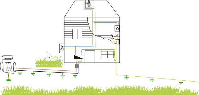

    I am puzzled by the diagram above. If the little grey rectangle represents the meter cabinet, there appears to be a N-PE connexion between it and the DB.

    Any thoughts on the diagram above?

  • Colin is here to change a light fitting. He has recently qualified as an electrician. He remembers his safe isolation procedure training and carries out the following sequence of operations and observations:
    • Turns the light fitting on. He observes the light fitting operating with the switch.
    • Turns off the circuit-breaker (CB). He observes the light fitting go out.
    • Locks off the CB and attaches his warning notice. The system is 100 A single-phase TN-S earthing arrangement, so he is happy with single-pole isolation.
    • Checks his proving unit and voltage indicator are functioning. All ok.
    • Carefully removes the light fitting’s cover and tests between line-earth, neutral-earth and line-neutral. Records 0 volts on every test.
    • Rechecks his voltage indicator with the proving unit. All ok.
    Now ask yourself whether he is safe to work?

  • would not help if it was a solid neutral type RCBO of course for this case of P-N reversal of supply. its not clear if the LE test read zero as the CPC was broken or because it was live, like the neutral - given how little the 's' in TN-s means these days. Its also not very clear how he got a bad  shock - if all exposed cores are live how was the shock path completed - one foot in an external flower bed perhaps?
