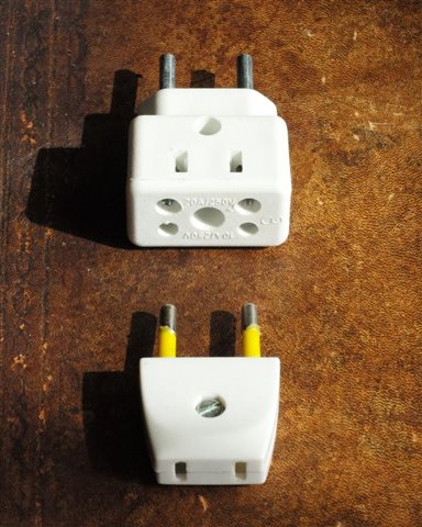

  • Brazilians
    Here are a couple of Brasilian electrical adapters which just happen to live in a desk drawer.
    As you can see, the larger one, which can accommodate three different types of plug (but not all at the same time), is rated at 20 A/250 V for the largest pins, so what have we got to worry about?
