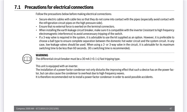

I'm currently installing a heat pump and noticed that some of the manufacturer's information says of the RCDs to be used with it:
...now requires the use of a Type B RCD/RCBO with the following specification:
  • Minimum detection capability up to 20 kHz
  • Minimum trip threshold of 150 mA above 1 kHz
and looking at the devices the manufacturer suggests, these seem to be nominally 30mA types.
So it seems to me these suggested devices may trip at 15-30mA at 50Hz, but may tolerate more than 150mA above 1kHz.
My first thought was where does this leave me with respect to section 543.7 (equipment having high protective conductor currents)? Can I assume that the 10mA limit only applies to 50Hz currents? or given the way the words are written should it be read as applying to all frequencies?

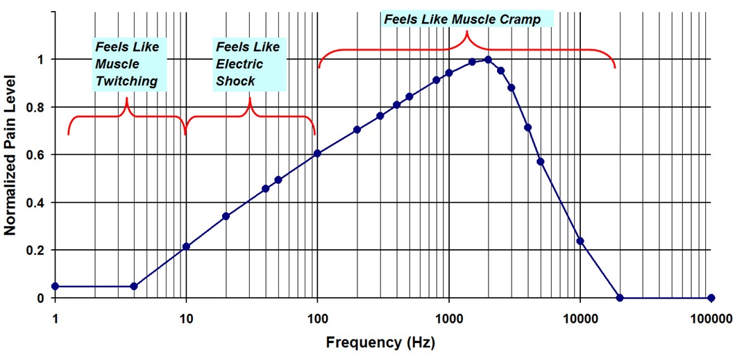

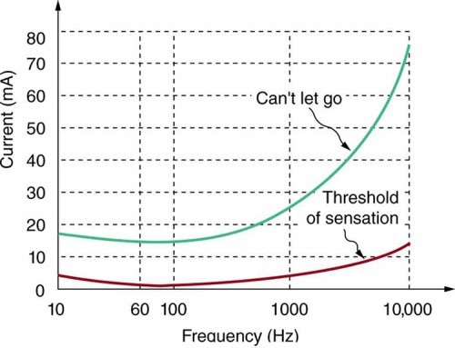

The other (possibly more important question) is how do currents at higher frequencies affect the human body - if I have a device that maybe doesn't trip until over 150mA (at 1kHz) do I still have additional protection? I think I recall that 50 or 60Hz is about the worst possible choice of frequency for shock considerations, but can currents at higher frequencies be safely ignored entirely?

    I notice Mike's graph is based on pain rather than effects that cause permanent damage or Ventricular fibrillation, so maybe there's still a bit of room for debate there (I'm sure I recall a 400Hz system for aircraft that was meant to have a reduced shock risk). But all the same we still have no solid evidence that higher frequencies can be safely ignored.
    For me that calls into question the effectiveness of specifying 30mA RCDs for additional protection in this case. I guess in the case of direct contact with live conductors on the a.c. supply side the residual current will still be 50Hz and so the RCD should trip as normal. But for other cases - e.g. a broken c.p.c. (single fault) the current flowing from the equipment case via a victim could well have high frequency high current components the RCD would ignore, but could still prove fatal. So my first question - whether we should have high integrity c.p.c.s seems justified,

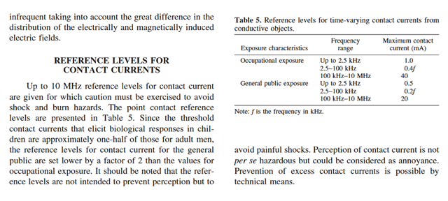

    This from ICNIRP may be of interest to you.
    GUIDELINES FOR LIMITING EXPOSURE TO TIME-VARYING ELECTRIC AND MAGNETIC FIELDS (1 Hz TO 100 kHz)
    While predominantly about radiation, it does cover direct contact as well.
    Note however that the numbers here are a factor of 30 or so lower than those used by BS7671 and the standards from which it derives its specifications... And, given results of rather worryingly simple/ dangerous tests like this, perhaps correctly so.
