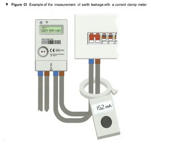

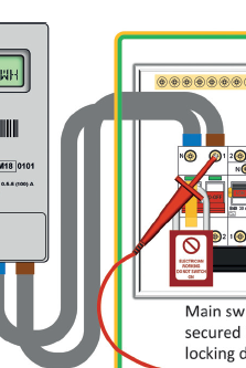

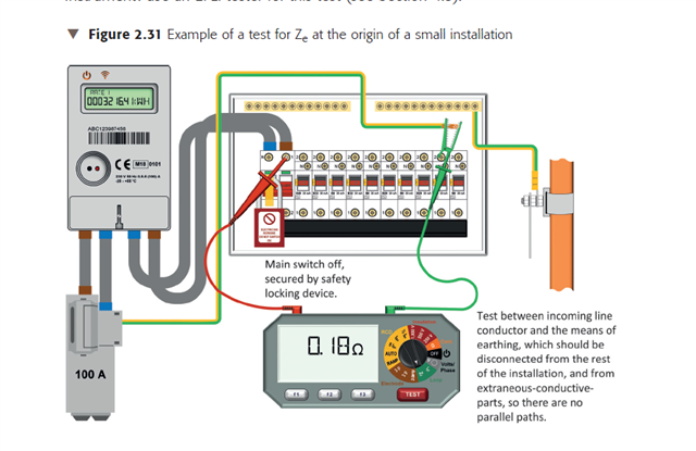

Is the diagram / picture incorrect?  Should it not show the Neutral/Blue in the middle under the meter and the Line/Phase on the outer part?  See attachment

  • While the polarities are correct at the meters, (although the colours/ tapes are reversed at the terminals), BOTH consumer units are indeed reverse polarity. Disconnection of the main fuse is required by the DNO, and the electrical installation given a thorough check over, including outside buildings/circuits.
    I'm not seeing that. Line conductor on right hand side of isolator (terminal 1), feeding through to busbar below on RHS (terminal 2)... neutral link from bottom-left to neutral busbar not shown.
    In fact, whilst now not always followed, traditionally, terminals in single-phase systems were frequently arranged to go "clockwise" from the top, similar to the concept of line at the bottom-left if PE at top-centre in socket-outlets.
    Of course, when providing illustrations for industry guidance, making things look too much like a particular product from a real manufacturer is to be avoided.
    I do, however, take the point that it wouldn't be easy to route the tails inside the CU in the Figure in Appendix C.

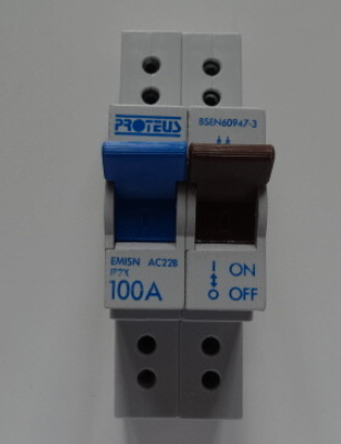

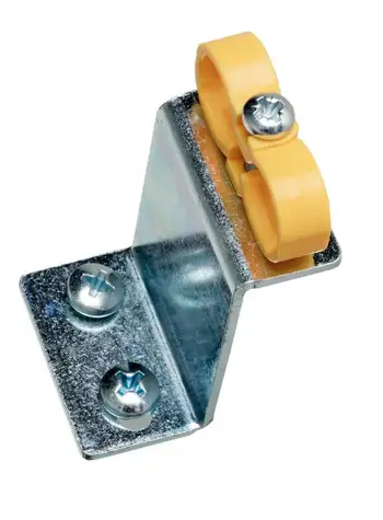

  • With reference to the picture I would also like to see it show the tails clamped/Cleat/supported between the meter and the CU.
    Inside the CU itself I would like to see the tails be either clamped or double screw terminal on the main switch.  A combination of both would be inherently the best solution.  Sample pictures below (other brands are available)
