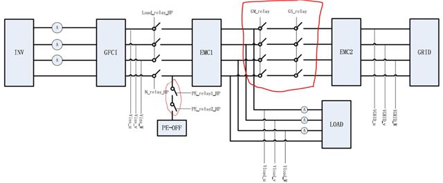

I am trying to understand if an 'Island mode' isolator is required for this particular inverter design.
The Solar PV Hybrid inverter has an 'EPS' (emergency power supply) output that we would like to use.
The inverter has an internal N-PE Bond relay.
In connected mode this takes its power direct from the grid.
In island mode the Hybrid inverter will have disconnected from the grid as per G98/99, and then the EPS is supplied from PV and/or battery.
So if the inverter is designed to disconnect from the grid during grid loss/outside protection limits is either an Automatic or manual changeover switch required?

  • So for a configured system where the inverter’s EPS setup powering a dedicated consumer unit, are we also required to install an external to the inverter, automatic, Line & N  island mode isolator on the inverter’s incoming side to ensure, auto disconnection of all live conductors during island mode, to comply with 826.1.1.1  and ESQCR Regulation 21? I can’t quite make out the image above, are both relays part on the inverter?

  • If Manufacturers have confirmed relays ( BS EN 60947-5-1) doesn’t meet Table 537.4’s isolation requirements. Have you asked the manufacturer to provide evidence that the relay meets isolation criteria, is it combined with another switching device to achieve safety compliance in the UK market ?
