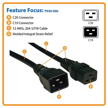

  • It may or may not comply with BS 7671, but please don't use the bs 4343 style yellow connectors for an earthed neutral 110V - pretty much everyone expects earth centre == split phase or 2 of 3.;-)
    Personally I'd mail order in a UL certified duplex GFCI socket - the internet is your friend.
    If you really must have joins in the lead then to use IEC connectors would probably be preferred.
