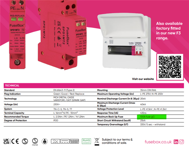

I am just off the phone with our genius SPD lady at SPD.  I mentioned the latest Fusebox distribution board which does not have an overcurrent device for the SPD.  The device is a Fusebox SPD1MT2 type 2 direct to busbar surge protection device.   She tells me that it is not compliant in accordance with section 524.4.5 and am inclined to agree.

    I don't think Regulation 524.4.5 exists in the latest version of BS 7671, unless I'm mistaken?
    As per the datasheet below it looks like the SPD relies on upstream fuse protection (<=100A gG required).

  • Interesting. thank you for finding that.  It does say that, and it says its a Gg so  That must be the incomer?  So, I wonder if that regulation for 'overcurrent with respect to short-circuit currents is being met?  It does still exist in the brown book. And, I might stick my neck out and question as much as 100A protection in terms of disconnecting the device.

  • I don't think Regulation 524.4.5 exists in the latest version of BS 7671, unless I'm mistaken?
    No, but 534.4.5 does.

    I would seek written confirmation from the manufacturers that the device is compliant.

    As I understand it, such devices are meant to have in-built overcurrent protection (if only a blob of solder type "fuse" which when opens also releases a spring lever that triggers the red 'replace' flag) - the upstream gG fuse is only needed for backup protection (like making M6 MCBs good for 16kA).
  • There certainly are designs with what is in effect an combination indicating fuse and thermal trip in series internally, and even versions where the indicator actuates a contact that can sound an alarm.
    ~Does the little circuit in the side indicate anything of use ?
    I'd expect and hope that the 100A fuse is not normally the thing that pops - if it was, that would be very awkward in many  situations.
    Perhaps on a supply with a massive PSSC and an unlucky dead short failure of the MOV - but mostly MOVs fail by leaking more and more and then becoming unpleasantly hot - hence the thermal trip aspect to the internal fuse - the blob of low melting point solder alluded to above.
