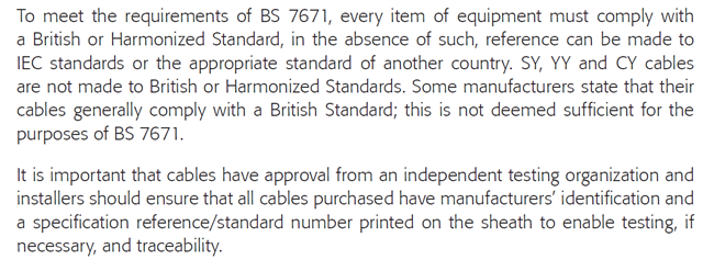

  • It seems to be the best cable for the job, and meets the German Standard, so you could make a note that you cannot ascertain if it meets British Standards, but if me, I'd be happy that the current carrying capacity and impact/wear/UV ratings are suitable, which from a quick search would show they are.
    Therefore the German (or any other foreign) standard may be used.
    Whilst on the surface, this appears to be the answer, I don't think it is.
    I believe that none of the standards quoted are a constructional standard for the cable as a whole; just like CY, SY and YY cables, the standards quoted by the manufacturer are for the component parts of the cable ... insulation, sheathing, conductor ... and fire testing, but nothing covers the overall makeup of the cable, and type test requirements for the completed cable.
    See NOTE 1 to Regulation 511.1
    So, the approach to using the cable in the first place is probably the same as OSG advice (Section 7.9 of the 2022 version) for non-standard cables such as CY, SY and YY ... designer satisfies themselves that the manufacturer has an appropriate constructional specification for the cable, and the cable has undergone independent testing/approval (e.g. BASEC approval), make statement according to and append details of this, specification and approvals, to EIC or MEIWC (Regulations 511.2 and 133.1.3).
    I’m trying to see if we need to comment / code it. Installation certificates are not available.
    Is there a potential safety issue? If not, it's probably a "C3" only if it might gives rise to danger?
    It was for the designer to make the appropriate decision and, if necessary, statement according to Regulations 511.2 and 133.1.3, but if you don't have the original EIC or MEIWC, for the installation of this cable, that boat has sailed.
  • Whilst on the surface, this appears to be the answer, I don't think it is.
    Graham, thank you - I see what you mean.
    So, it seems reasonable to me to make an observation to the effect that compliance with 511 cannot be verified given the loss of the original paperwork.
    I cannot help feeling that C3: it is recommended that the cable be replaced with one which conforms to a British or Harmonized Standard would be unhelpful. Much better would be to specify the recommended Standard, but perhaps no comparable one exists?
