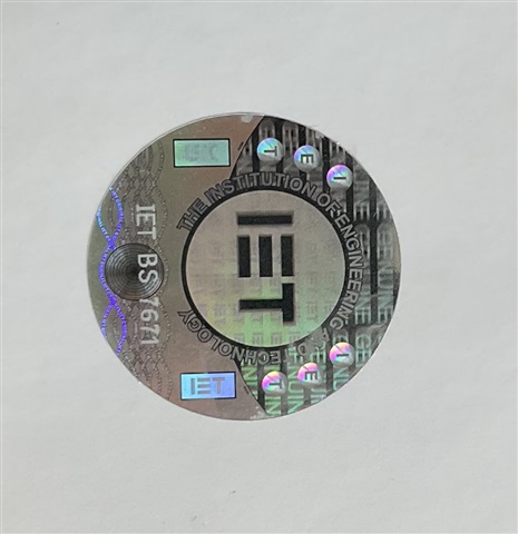

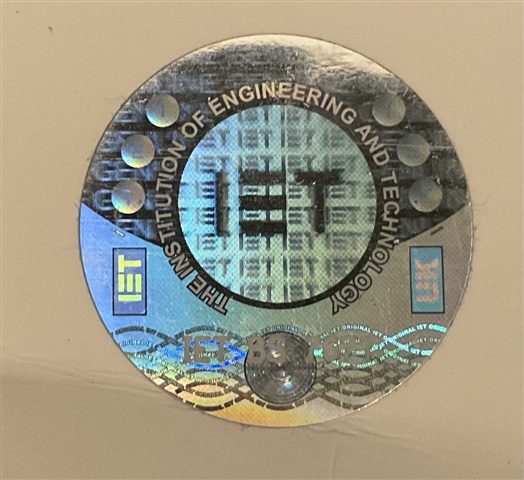

  • Counterfeit hologram.
  • What is I presume is a genuine hologram having bought this book myself from a reputable supplier, there are couple of noticeable differences, the upended “IET” and “UK” are reversed, but overall there’s little difference.

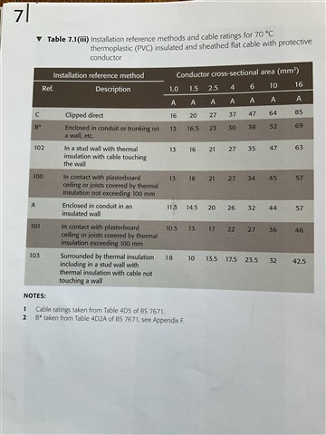

  • I'll use the 1mm in case 103 please, as it can take more current that the 1,5mm in the same environment. yeah right,.
    Mike
  • That 1.0 mm is really good, it will carry more current than the 1.5, 2.5 and 4.0 mm.
    It is obviously wrong, but other errors may not be so apparent.
