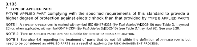

    ETA: I have now found a reference to, "applied parts" and, "type BF" in BS EN 80601-1 and of course, there is the definition of, "applied part" on page 37 of BS 7671:2018+A2:2022.

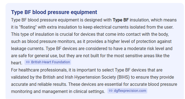

    The equipment is as below

    Your description in the OP seems to be a perfectly ordinary consulting room (what the Americans call an "office") as opposed to a treatment room. I remain to be convinced that an ordinary sphygmomanometer is an applied part, in which case the location is Group 0. However, it's use could change and it is probably as well to treat as Group 1.
    I think that care needs to be taken with the term, "blood pressure monitor". Part 2:34 of BS EN IEC 60601 applies to equipment which uses a transducer which has been inserted into an artery and is connected by wires. Clearly, that poses a risk in the event of malfunction.
    The definition of a sphygmomanometer is very brief in OED: An instrument for measuring the force of the pulse. Strictly speaking, it measures the blood pressure only indirectly. So the pressure which blocks the flow of blood in a cuff around the arm is just above the peak blood pressure (systolic). How such a cuff, which is attached to the medical equipment by rubber tubes, could present a risk of shock is completely beyond me.
    I assume that in the consulting room, the consultant will take the blood pressure once (or take the average of two or three readings) rather than monitoring it during the whole consultation. That said, modern sphygmomanometers can take intermittent readings where monitoring is essential (e.g. during surgery).
    I venture to suggest that the definition of, "applied part" needs to be reviewed. Clearly, there is a difference between an applied part, which makes electrical contact with a patient, and one which cannot. A good example of one which does is an e.c.g. machine.

    I thought that this article is very clear and sensible. So, unless I have misunderstood the situation, your blood pressure monitor is not BF.
