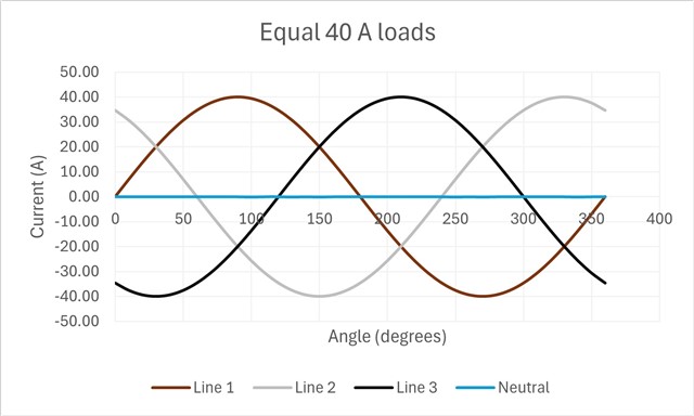

  • I was trying to insert a wee spreadsheet to illustrate the point, but failed miserably. Is this possible please?
    ETA: in the mean time, here are some graphs.
    A perfectly balanced load has no current in the neutral, which can be omitted if the load will always be perfectly balanced, e.g. a motor.

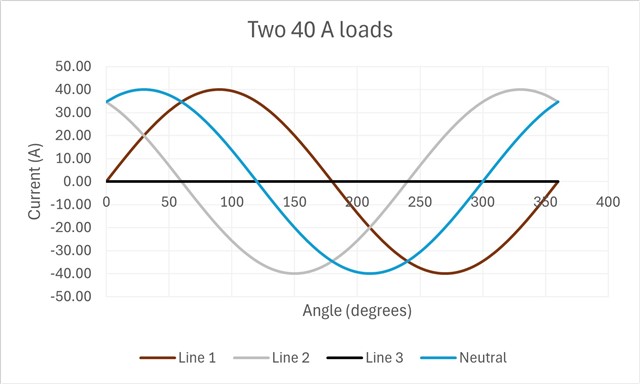

    If one of the phases is removed, the neutral current rises to the line value, but no more.

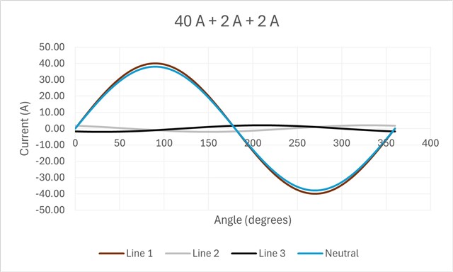

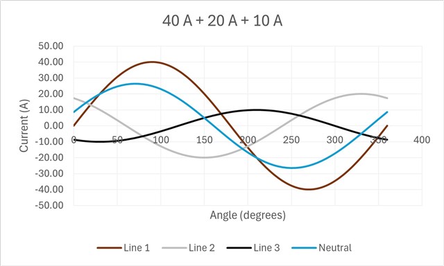

    If the loads have different values, the current in the neutral is lower than the highest line.
    If two of the loads are small, the situation becomes similar to an SP circuit with its equal line and neutral.
