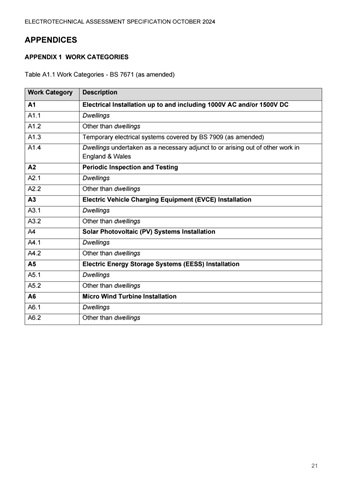

  • The EAS document:
  • I think that here some are using the phrase 'domestic installer' as a diminutive
    The vast majority of dwellings must have single phase and one consumer unit. Compared with a factory or a hospital, even a small one, the installation is much simpler.
    Let us not forget that, legally, registered CPS are for dwellings. In a sense, the exemption from obtaining building regulations approval in advance is a privilege. However, I do not think that your local authority would cope if every new circuit, etc. in a dwelling had to be notified.

  • It is important to note that a domestic installer is not an electrician. "
    which strikes me as an odd thing to say...
    The statement in the article is correct, providing you subscribe to the view that a qualified electrician must have a NVQL3 or equal. The domestic installer qualification is level 2. For contractors involved in a CPS, the EAS allows them to potentially move “employed” persons with such qualifications and sufficient experience into a lower risk category thereby lowering the amount of QS oversight required. The requirement remains, however, that the work of the “domestic installer” must be inspected and tested by an electrician.
  • The requirement remains, however, that the work of the “domestic installer” must be inspected and tested by an electrician.
    I do not think that can be correct because a domestic installer is entitled to self-certify notifiable work.
