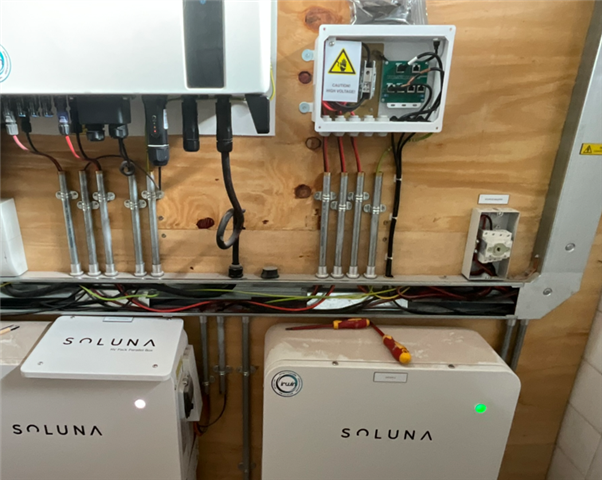

Wiring system for solar PV
Neat enough job and probably technically compliant, but is it sensible to put the DC side conductors in metallic trunking and conduit even if they do meet the class 2 or equivalent requirement?
I am aware that there are SWA cables specifically for solar PV, so I guess there is not much difference if the SWA is earthed. However, on a slightly different point, if these SWA DC cables are buried, what is the point of earthing the wire armour?
Parents
  • Good points, by default, DC conductors in metallic trunking is standard for the majority of commercial installs, mechanical protection of the cable being the primary driving factor with little concern given to the risk level of insulation breakdown. On the point of buried SWA DC cables, most cable runs will have a portion that's touch accessible either at the inverter or panel end, which could be classed as a potentially exposed conductive part, hence the earthing consideration.
