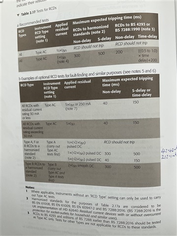

  • A multiplier of 1.4 comes to mind, so with the instrument set as in the photo (30 mA × 1 × 1.4) = 42 mA ?
    Why?
  • I'm not sure of the exact derivation, but the IET Wiring Matters article concurs:
    'When the Type A setting is selected on the instrument, a half wave pulsating residual test current superimposed on a smooth direct  current of 6 mA is produced, which effectively applies a 1.4 multiplier to the rated residual current (IΔn). For example, if the 30 mA setting is selected, the RCD will be subjected to a test current of 42 mA (30 x 1.4 = 42 mA)'

  • I think that I have an explanation.
    The rating of an RCD is the nominal RMS value of the alternating residual current which causes it to trip, IΔn.
    The RMS value of a sinusoidal alternating current is the peak value divided by √2, but for a half-wave pulsating current, it is half the peak value. The difference in RMS value is because the first step is to square all the instantaneous voltages. Rectification takes half of them away, so the mean square value is halved. When the square root is taken, the RMS value of the half-wave current is not the RMS value of the full sinusoidal current divided by 2, but divided by √2.
    So for a 100 A peak, the RMS value of the alternating sinusoidal current is 71 A, and for the half-wave rectified current it is 50 A.
    Table 1 of BS EN 61008-1:2012+A12:2017 gives the maximum values of break time for full a.c. for types AC and A RCDs at IΔn, 2 IΔn, and a choice of 5 IΔn, or 0.25 A. Table 2 gives the maximum values of break time for type A at 1.4 IΔn, 2.8 IΔn, and 0.35 A (which ≈ 0.25 A x √2).
    Unsurprisingly, the maximum values are the same because the mains voltage, and hence current, has not changed, it has simply been rectified. If the tables had used the peak current, they would have been identical.
    I hope this makes sense.
