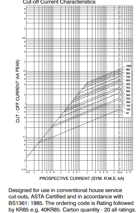

    Here is a bit more on how important it is that the supply fusing between the substation and the MCB is the right energy limiting type above 6A. Example Bussman 1361 house service fuse data.  A 6kA breaker on a supply with a different upstream fusing arrangement, is NOT guaranteed to survive or fail safely on supply with  a PSSC above 6kA. Old cut outs with unknown or rewirable fuses may need to be changed, or augmented by a modern fuse but there are hopefully not too many left in use.
    Similar shaped BS88-3 curves from Merson (page 50...) show a closer energy limiting action.
    The values of I2T is the total let-through - this is what  damages downstream equipment. Quoted pre-arc levels are also quite different.
    TYPE RATING (A)  I2T I2T LOSS(W)
    BS88-3   BMF42V100 100   68000 5.8
    BS1361 100KR85 100  73,500 6.1
    In any case, once above 6kA PSSC at the incomer, it is very important to check  the supply arrangements in terms of upstream fusing.
