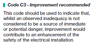

  • If the inspector considers that an item, although not warranting code C1 or C2, requires improvement, it should be given code C3 on the EICR.
    I have dismissed the wording in GN3 as a mistake.
    The above from Best Practice Guide 4 Version 7.2. Note the wording difference in a previous version below. Omit "significant" and a C3 can apply to any pittance of an enhancement, perhaps designed to accommodate those pushing AFDDs!! (Sorry for the cynical remark, the City and Guilds debacle has angered me and coloured my view on any guidance that can be tainted by a commercial connection).
  • Lex de minimis non curat.
  • I don't see any mistake there.  If something does not cause any immediate or potential danger, how does fixing it produce a significant enhancement of the safety of the installation?

    I think Lyle's concern is that the upper of those two quotes leaves open the door to a "make-work" approach to very marginal improvements, and someone may quote to go round oversleeving red cable with brown or something, that is equally neither cost effective nor desirable and brings the business into disrepute as rip-off merchants.
    M
  • I am inclined to agree with Simon. The word, "significant" is otiose because you would not code a non-compliance which is trivial - e.g. red and black conductors instead of brown and blue.
