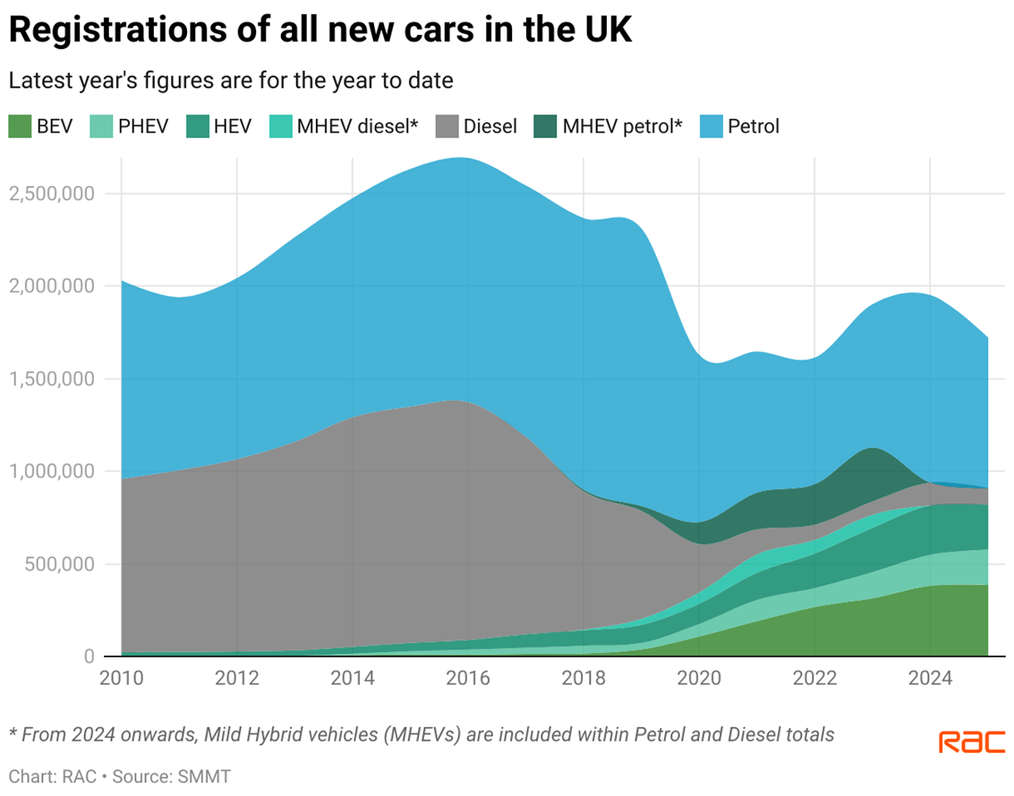

The UK is seeing a large move towards EV (Electric Vehicles) from traditional ICE (Internal Combustion Engine) there have also been several well documented Car park fires in the last decade.  Eg Luton Airport Car park October 2023 with over 1500 vehicles destroyed or damaged
