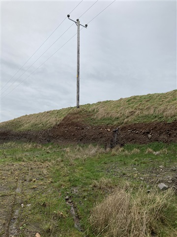

If 7671 applied to HV and DNO equipment, might this be a code 3 if subject to periodic inspection? It is an 11KV pole on  next to my house  on land which was abandoned following failed planning permission for two houses. Following my notification of the possible danger of land slip, the DNO said it looked stable and they didn’t have concern. The photo below is the situation that prevailed when I notified them last year.
  • I suppose that much depends upon the depth of the pole, but it appears still to be plumb. I do not think that it would worry me.
    What is at the top of the bank please?
  • What is at the top of the bank please?
    Agricultural land sloping upwards for around 80m.

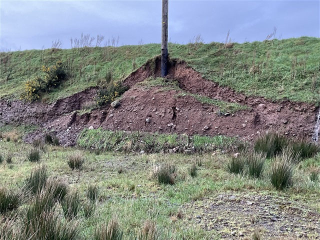

    Nothing to compare plumb to but it certainly now seems to have a slight lean toward the lower ground.
    Taken just now;
  • It'd hard to be sure from the picture - I'm guessing the exposed soil is a "cliff" formed when the foreground was levelled?
    If so how far away/above is the base of the pole from the base of the "cliff"? (I'm thinking that the general rule for supporting ground is that it needs to extend at 45 degrees from the base (i.e. if the horizontal measurement exceeds the vertical one, you're probably OK) - although it might want to be a bit further in this case to counter the tendency for the pole to lean in the wind, but you could knock a bit off to account for the depth of the pole. So one unknown vs another.

  • Ah well, that's a C2.
  • Ah, OK. Perhaps another call is in order then!

  • is that brown strip a ditch or an embankment ??
    If the poles have been properly planted to the design depth, there is unlikely to be a sudden problem unless quite deep excavations, up to about a 70cm close beside  will not be catestrophic, but may be unwise.
    Things at risk of falling over are normally stayed, so I assume the ground was surveyed as  good when it went in.

    In summary there should be more than at first appears below ground, so assuming it does not wobble when you hit it, it probably is OK !
