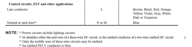

I'd like to run some extra cable between my house and our heat pump for possible future use for controlling 3-way valves. My understanding is that BS7671 asks for 3-core control wire to have the neutral/mid-wire be blue, and the other two wires to be one of a range, but not yellow/green like an earth wire. Our heat pump asks for these wires to be 0.75mm2 CSA and as they're for mains voltage they'll have a suitable voltage rating too. However, I've searched around and can't find any 3-core cable which complies with all of these requirements.

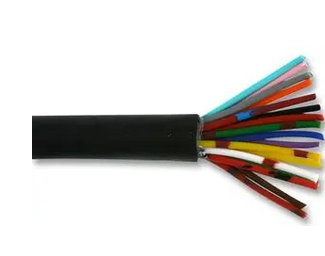

The main sticking point is the colour-coding. I can only find 3-core cable in either standard mains colour-coding (brown, blue, yellow/green) or in 2x black and 1x yellow/green. I thought of running a cable with many cores, as I need to run a bunch of 2-core as well for other possible future uses, however all the multi-core I can find also follows the black+yellow/green coding. I can't find any suitable 3 or multi-core wire that has any blue cores!
So, I was wondering what's acceptable, or what's the common practice. Just use either the mains or the black+yellow/green multi-core wire and sleeve it to make it clear what's doing what? Or do I not need to do anything at all?
For reference, the existing wiring from the install done a year+ ago uses a black+yellow/green multicore to run out from the wiring centre to the heat pump, and mains-coloured 3-core inside the house from the wiring centre to the connection box with the 3-way DHW valve. This suggests to me that black+yellow/green multicore is acceptable without sleeving, however it's the fact that BS7671 seems to ask for a blue core which has me bamboozled.

  •  then why aren't all cables just black multicore with a yellow/green for earth? Yes sleeving is allowed, but it's not preferred if the right colour cores are readily available is it?
    Anyway, in this case I can't find the cable with cores in the right colours, so I'll have to use sleeving anyway.... and to be compliant with both BS 7671 and BS EN 60204-1 I should use blue and red sleeving on the neutral and red and one other colour on the live conductors.... but I think that's probably getting a bit silly.

    SWA would be the usual choice for outdoors/underground.  You could use 3-core, oversleeve black with brown as your 2nd L and grey with blue as N and use the armour as the c.p.c.Or four-core (which has a blue core) and oversleeve for 2nd L and c.p.c. or 5 core which usually gives you a blue and G/Y cores (plus a spare core for future expansion). (The armour still needs earthing at at least one end whatever).

  • I will admit that I'm starting to get a bit lost with all the standards, variations, possibilities. However, maybe going back to the root of my original question, which is why the wiring regs say that for control the colour of the neutral or mid-wire must be blue:
    electrical.theiet.org/.../bs-7671-2018-corrigendum-dec-2018-v2.pdf
    I've referenced a free corrigendum because 1) I don't actually have a copy of the wiring regs to reference and 2) the corrigendum is freely available for anyone to access.
    I appreciate that in most 2-wire control cases a simple L+N brown+blue 2-core cable will suffice. In my case I'm looking for a 3-core cable for control of a 3-way valve, which in a domestic setting isn't that unusual for a heating system. If this is a fairly common type of cable-need, then why can't I easily find this kind of cable in the UK? I appreciate that there may be another standard for colour-coding of 3-way valves for heating systems which I'm not aware of (just as I wasn't aware that BS EN 60204-1 would apply to external wiring for a domestic heating pump). However, if I've not missed something, then why can't I find this cable which surely must be needed in lots of situations in the UK? Maybe the answer is just that it's not needed frequently enough to justify the existence of a specific cable.
    Or, maybe 3-way valves were never the intended purpose for the colour-coding for control wiring in the wiring regs? If that's the case, then what does it mean by "mid-wire"?

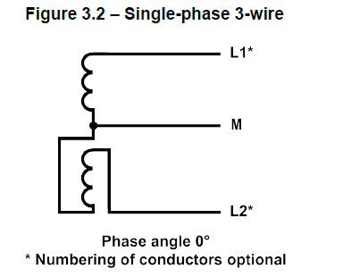

  • then what does it mean by "mid-wire"?
    It's to cover "neutral like" cases in some less common supply arrangements, e.g. the "M" wire in this diagram (from BS 7671 section 3 - the "coils" represent supply transformers):
