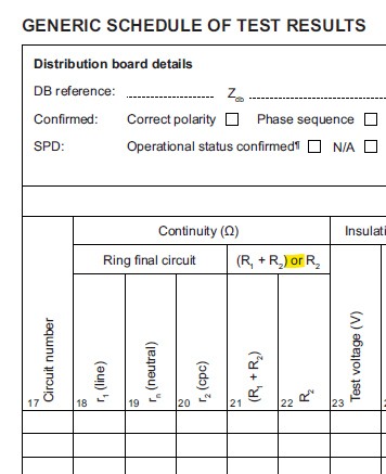

  • Ok, if you are doing an EICR, these results are asked for also it asks for a r1r2 or2 reading (at least one column to be completed) so, if we are keeping all earths connected and doing a r1r2 or a live test Zs, I am asking why it is ok to add ZE/ZDB to r1r2 but not ZS from ZDB to attain r1r2. Is there any reason why it is frowned upon. You are demonstrating there is an earth path either way and proving continuity either way surely?
    I disagree, read the Generic Schedule of Test Results form in Appendix 6 carefully. The form asks for '(R1+R2) or R2'
    The reason one or the other, is it depends on the test method used for 'Continuity of Protective Conductors'.
    For radial circuits:
    • If you use the (R1+R2) method for continuity of protective conductors, you enter the value measured for (R1+R2) in column 21 and N/A in column 22
    • If you use the 'wander lead' method, you enter N/A in column 21 and the measured value of R2 in column 22.
    The practice for ring final circuits is:
    • Carry out end-to-end tests (step 1). Write the measured end-to-end values for r1, rn and r2 in columns 18, 19 and 20 respectively.
    • Carry out the 'figure of 8' tests (steps 2 and 3).
    • Write down the greater of [(R1+R2)/4] or [largest measured value in the figure of 8 test step 3] in column 21, and 'N/A' in column 22.
      (NOTE: in theory, the  [largest measured value in the figure of 8 test step 3] should not exceed [(R1+R2)/4] so usually it's [(R1+R2)/4] that goes in column 22.)

    if on an EICR you are doing live testing and the cert is asking for one or the other r1r2 or r2, what is the difference?
    Then the industry practice would be to record 'LIM' in the R2 and R1+R2 columns because you didn't do those (continuity) tests ... and explain the reason for the limitations in the relevant section of the EICR form.
    I'm asking why, if we can do ZDB and r1r2 to calculate Zs why not back calculate. I know doing two tests would give you different values but I'm asking if you done ZS-ZDB to put r1r2 in, why is this frowned upon if you are keeping your circuits connected to the earth bar when doing r1r2? On an EICR it asks for reading in the box either r1r2 or r2.
    See above. If you didn't do those continuity tests, there isn't a result.

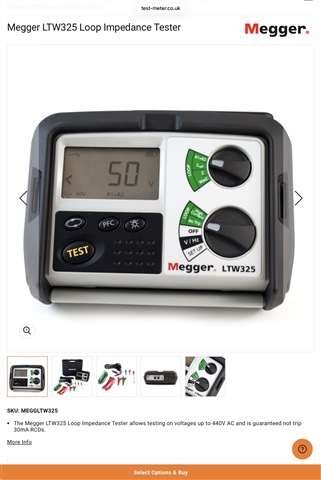

    So no one can give me a definitive answer to above. If you are not meant to live test why do you have a meter that does. As asked why is it ok to do live ZE but not Live Zs? Surely if you do a live test at end of line you are proving continuity on the cpc? Or am I missing something?
