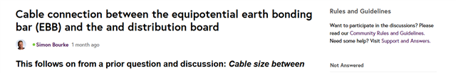

Group 1 Medical location EBB - connection to the protective system earth - risk in choice of connection location.
A similar question was asked a month ago, but there seems to be no answers to this, I suspect it was because the question may have been too wide ranging.
The question was this:
However to rephrase this question.
Consensus on this forum was that whilst the regulations are silent on the specific location of where the Equipotential Bonding Bar should be connected to, connection to the local DB (distribution board ) rather than the system origin would suffice.
It would therefore indicate that a direct connection from the EBB to the system source would also be BS7671 compliant. If not can this be clarified?
On the basis that there is a choice of where the EBB is connected to the system earth, then (after my long preamble) - please can you advise with respect to this question:
If the EBB of a medical location is connected to a local DB, is there an increased risk to the integrity of the earthing arrangement?
