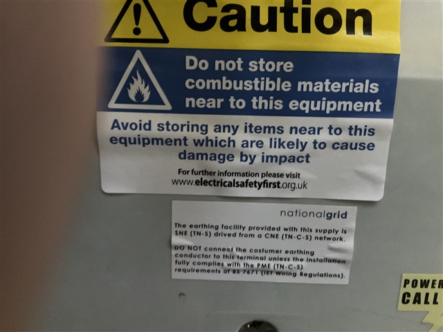

  • Here is a excerpt from APEA 'Blue Book' Guidance for Design, Construction, Maintenance and Decommissioning of  Filling Stations.
    It has a bit more detail than 60079-14.
  • Unfortunately, 'SNE' is not a defined term in BS 7671, and neither BS 7671 nor IEC 60364 series internationally recognize 'TN-S derived from TN-C-S'
    However, the label correctly advises to treat the installation as PME (TN-C-S) for the purposes of BS 7671.
  • It has a bit more detail than 60079-14.
    Agreed ... but even there, there's still a need to understand that physical separation is needed between the earth electrode, protective conductors and exposed-conductive-parts in REF C and REF E supplies, from exposed-conductive-parts and buried metalwork connected to the primary supply ... both to conform to BS 7671 Regulation 411.3.1.1, and to prevent transfer of voltages and currents below ground. The worst-case transfer of voltage we are looking for is not 70 V AC, as in EV charging installations, but 25 V AC.
