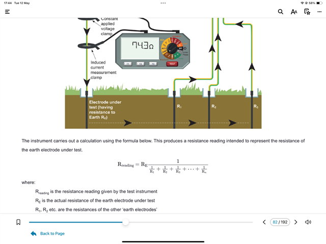

  • Strange that this from the ebook is wrong but correctly set out in the paper version (+ missing between Re and the parallel arrangement).
