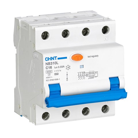

Does anyone have any experience of this ? Can you get a 3 pause 16amp rcbo ? The board is 3 phase but we never fit 3 phase breakers as its just standard houses.

  • you can get both 3 phase, and 3 phase with neutral, but not cheap, and you may be cheaper and same effect, to have separates, and then if running in armoured cable there is also an option to put the MCB indoors and the RCD part outdoors, especially if the MCB is in some sort of locked plant room.

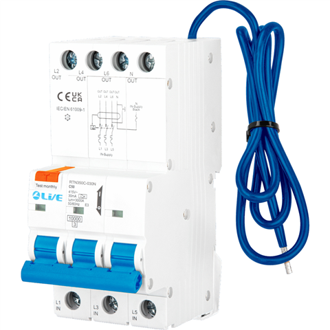

    Be careful - there are some makes with designs intended for 3p bus bars with neutral fly wires..
    example  note 4 screws on top and 3 below ;-)
    others are more conventional  4 in 4 out
     Of course sods law says that the ones that fit the box you have are not available in the right style.

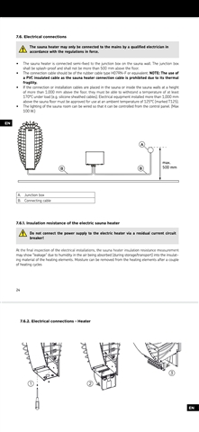

  • Apparently hager said i need a standard 3 phase mcb and then a rcd attachment to make it a rcbo effectively
    This sauna is 9kw so I think 3 x 3kw heating elements
