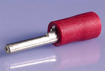

  • Yes  - it is all perfectly fine, as long as suitably terminated (for some terminals expecting solid core such as on contactors or similar that may require the addition of bootlace ferrules or maybe pin or  fork lug  crimps to avoid a 'stray strand' issue.)
    and installed sensibly with good cable grip ( think compression glands mainly) - and, like any cable really,  not in a place where it will be snagged or run over.
