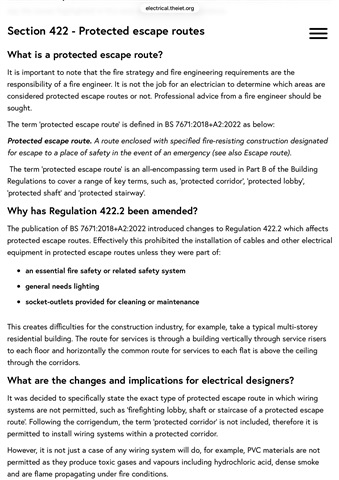

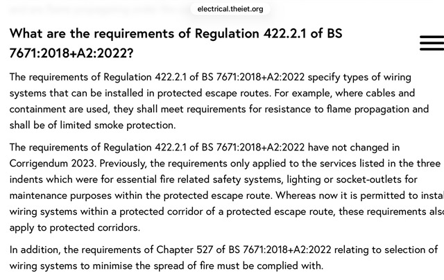

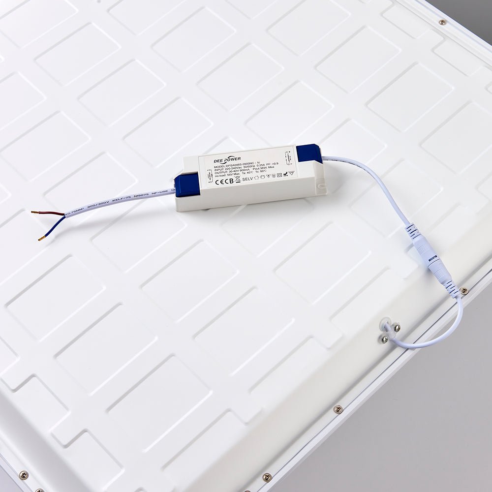

Hi - I'm currently working on a residential project that has a protected corridor. I'm happy with how to deal with the general wiring and compliance, however I have been asked the question regarding the cabling between the luminaire and the driver. How to make this compliant, has anyone else had this issue. Section 422.2 clearly addresses the supply cable requirements but I can't find anything relating to the driver cables. Help most appreciated.

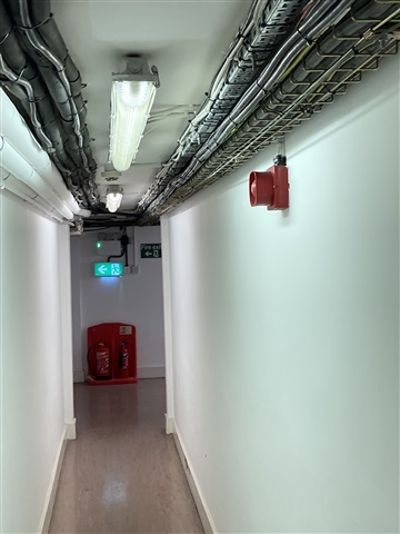

    So back to the ceiling, if the suspended ceiling is a fire barrier,  is the void above the corridor ceiling in the corridor?
    The light fixture referenced above is TP(a) Rated, I presume it’s not actually fire rated and won’t stop a fire breaching the suspended ceiling if it is a fire barrier? So the void above the ceiling is in the corridor?
    www.lighthubdirect.com/.../emergency-pro-tpa-1200x600mm-led-40w-140lm-w-light-panel-recessed-for-office-suspended-ceiling-white-4000k-neutral-white
  • The suspended ceiling is not a barrier so effectively the void is in the corridor, it's being treated as one space. The fittings selected are not fire rated as the ceiling is not a barrier so we didn't think it necessary. I've already spent time on this and spoken with manufacturers and Fire advisors etc, I was really wondering if anyone else has come across this issue and how they handled it. It sounds as if it's one for the manufacturers.
