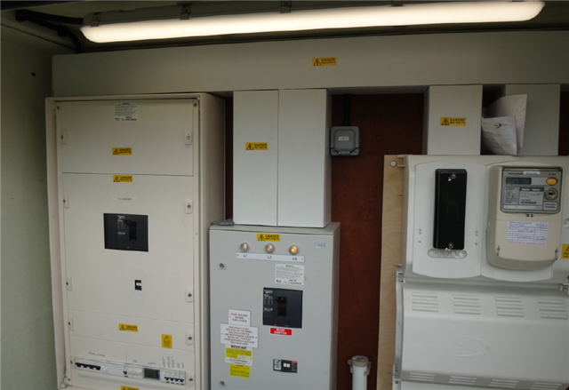

    Not a farm, but picture from a fuel filling station typical origin set up where we do not use the DNO earth, but install a TT earthing arrangement.
    So right hand side is the DNO cable head ( Yes, they do manufacture and install insulated ones) then the double insulated meter tails pass thru plastic trunking to again an all insulated enclosure that has the four pole main protective device with adjustable rcd as we typically have three levels of time/earth leakage current cascading. main conductors then come out of that main protective device to the section board on the left hand side of the foto and obviously now a metal enclosure earthed to the TT arrangement.
    So maybe something similar would suit your needs?
