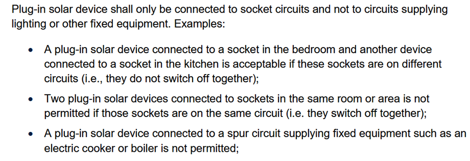

  6. The electrical safety study showed plug-in solar was safe at a circuit level. Should the Interim Product Specification limit the number of microinverters to one per household or one per household circuit?

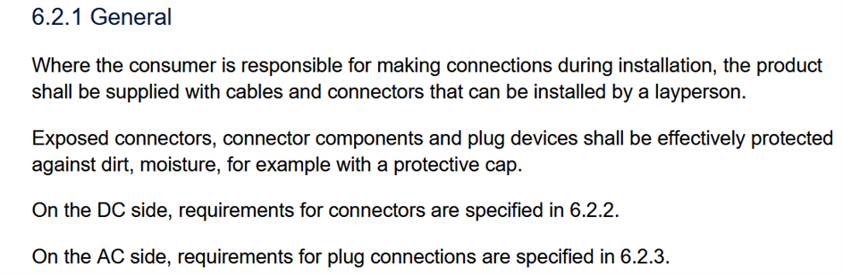

    I will be suggesting that for semi-permanent wiring outdoors a 13A plug is not a good choice, so allow for or even encourage  more waterproof alternatives. and a 5A fuse is not a recommended value - if a 5A fuse is really needed because a 13A one is too big, it should be in the equipment.
    I'll be pro 'one per circuit' so you can have more than one per house, but only if there is a strong recommendation to take the advice of a suitably skilled or competent person about the suitability of the wiring and the division of final circuits.
    The Analytical Annex acknowledges that a minority of households may need some professional support, but one per household is my preference, at least for now, given that the product standard is interim. Keep it simple.
    The alternative is that you start getting into EICR territory. That said, it might not be a bad idea to add suitable/unsuitable for plug-in solar to the existing list in Appendix 6 and the model form.

  • For components that are only intended to be used internal to a property, they should have
    ingress protection of better than IP44 to avoid electrical hazard if water is spilled upon them.
    Humm, a 'better than IP44' 13A plug might be interesting...
  • 5A fuse is not a recommended value
    There are precedents for non-preferred fuse sizes ... IIRC the standard for wiring systems for office furniture demands a 7A fuse for each outlet.
  • indeed - hence my comment that it would be safer to de-fang the PSSR a bit more and permit almost any other connectors that are actually designed to be left outdoors in the UK weather (even some  that don't have shutters boo-hiss, but are finger proof by dint of the hole size )
    A lot of 'outdoor' 13A sockets are only really weather-proof with nothing plugged in to make sure the flap closes.
    like this popular Gewiss model
    Fine for a lawnmower you unplug when not in use, then its IP 55 with the flap shut apparently,  but I'd argue not really if its left with the `flap up in the rain

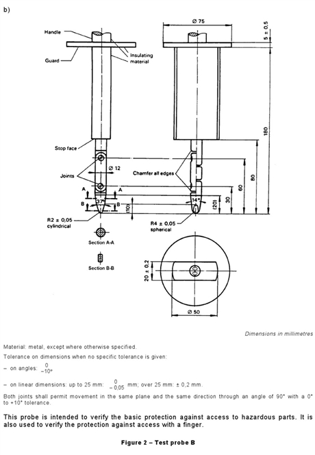

    There is also a related and  slightly odd question of why there  in effect a very poor  equipment IP rating set by " BS EN 60529, with Test Probe B" as this is in effect IPXXB - so much much weaker than say IP44.
    regards
    Mike
    PS
    That B probe 'finger' allows 11mm holes with live part  a few mm behind or larger holes up to 19x49mm with only basic insulation behind and allows exposed  things wed normally worry about like choc block the large finger tip cannot touch.
    1. Finger Diameter: 12 mm
    2. Finger Length: 80 mm
    3.Stop surface Plate 50* 20mm long axis at right angles to knuckles
    4. Baffle Plate Length: 100 mm
    5. Baffle thickness: 20 mm
