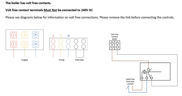

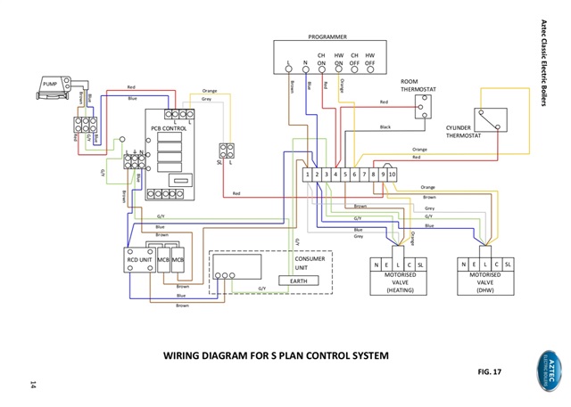

My specific question is whether the boiler and the external wiring controls (we have a Reliance 8 zone wiring centre) should be on separate circuits? The wiring requirements state: “Miniature circuit breakers (MCB) MUST be fitted between RCD unit and boiler and RCD and any external controls….An additional MCB rated 6A will be required to supply the external controls.”
The current setup is the boiler and controls are on a 63A type B RCBO, with a switched fused spur on the same circuit for the controls. Whether this was ever correct/appropriate for the previous boiler I can’t say, but the installer has obviously just tried reuse what was already there on a like-for-like basis with the new boiler (different manufacturer/model).
One electrician has said the external controls should have been installed on a separate circuit with its own MCB, and the other that it can be on the same circuit and just replace the fused spur with a 6A MCB.

  • Certainly the power for the boiler and controls should be on different circuits (just make sure there is the correct separation between the two - e.g. the relay/contactor on the so called "volt free contacts" on the boiler). Introducing an MCB or fuse, by definition does create a new circuit though, where ever it's fed from.
    Running heating controls off a fused connection unit (with a 3A or 5A fuse) is pretty normal in the wider world (and often provides a convenient isolation point) - I can't see that using a 6A MCB makes any practical difference (other than easier to reset if there's a fault, but if there is a fault, there would be a lot of investigating to do first so the replacement of a fuse would be the least of your worries). Tapping off the 63A circuit is a bit odd, while there's nothing particularly wrong in principle, 16mm² wires aren't going to be exactly a nice fit into fused connection unit terminals and using smaller cables for that bit will need care and some detailed calculations to prove it's OK (a bit of 2.5mm² T&E almost certainly won't be). A Fused connection unit off a local socket circuit might be a more common arrangement. Or a dedicated 6A circuit from the consumer unit - all seem valid options to me.
    Manufacturer's instructions are often a bit, let us say, simplified - perhaps targeting one particular situation and ignoring other valid ones (these seem to presume the "split load" consumer units that were popular in the past, but are falling out of favour these days). We used to be constrained to "follow manufacturer's instructions" but after a lot of complaints about instructions not making an awful lot of sense (or often being originally written for non-UK markets so not considering UK practice and regulations) the regs these days only require that we "take account of" manufacturer's instructions - which gives a bit more leeway - at least as far as the wiring regs are concerned (manufacturer's guarantee dept might take a different view of course).  (The reference to "IEE Wiring Regulations" is a classic indicator of instructions not being well written, copied from something else or not kept up to date - it's been the IET rather than the IEE for several decades now).

    A 63A RCBO will be fine for the boiler in terms of overload, and handling earth faults, and to fuse down to 5A locally to create a new circuit  for the controls makes some sense in terms of ease of isolation for servicing.  If the hop of thin wire from the 63A submain to the input side of the FCU  is short (advice is less than 3m) and well contained, so a dead short there is unlikely, then it can be rated for the load, rather than the supply, and be as thin as 1.5mm2. A short length of 4mm2 or 2.5mm2 would feel better however. For a longer length then some adiabatic sums would be needed, and makers data about that RCBO.

  • I wonder if what the Manufacturer is trying to say is that he would like the power & control supplies to come from separate OCPDs so that, in the event of failure of the main heater supply, the control system remains alive?
    This could be for similar reasons as to why a gas boiler utilises a 'pump run-on' facility to allow heat to be removed after the flame has been extinguished. Ensuring the control system remains alive could allow a circulating pump to strip any remaining heat from the boiler in the event of sudden disconnection of the heater supply.
