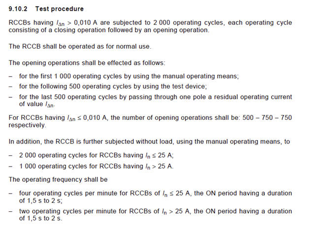

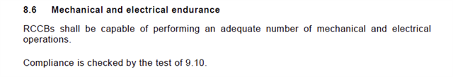

  • That is twice the minimum specified in BS EN 61008.
    Is it? I don't think the actual number of cycles the RCD has to meet in service is specified, only the numbers of cycles that are tested during type tests.
    In BS 61008-1:2012+A12:2017, the current UK designated standard, the total number of cycles tested during type test is 4000 mechanical and 2000 electrical for devices with nominal (load) current rating up to 25 A, and 3000 mechanical and 1000 electrical for devices with nominal (load) current rating exceeding 25 A?
    I agree that GN3 is perhaps being a bit pessimistic. Even if an RCCB is operated 20 times per year, it would still take at least 100 years to wear out.
    Some RCDs are used in installations that have more frequent inspection and test periods than one year. The shortest periods between formal inspection and testing quoted in Table 3.2 of IET Guidance Note 3: Inspection and Testing are, effectively:
    • 3 months for construction sites, although it's reasonable to expect a "test button" check before each use if an RCBO is used for each socket-outlet on a site distro board (which could be multiple times per day, but to be pragmatic, say 20 times per week). For a Type A, if we do full tests, that would be a minimum of 4x4=16 operations per for formal I&T, 50x20=1000 operations per year for routine check before use (assuming a 2-week shutdown) ... might just bring this in at under 4 years usage. For devices rated above 25 A nominal current, this drops to under 3 years. C
      Pragmatically, these periods of a small number of years might be OK for some sites, but site distro boxes to get reused, and no-one keeps a log of exactly how many trips have been made in the mean-time.
    • 'Each hire' for mobile and transportable units. this could be weekly ... certainly multiple times per year. Again, falls far short of 100 years.
    In a workshop environment, where SRCDs are used, they might well be manually tested each day... so similarly, we're looking at 4 years of mechanical operations for devices with nominal current rating not exceeding 25 A, similar to a construction site, without any additional tests for periodic inspection and testing.
  • Is it? I don't think the actual number of cycles the RCD has to meet in service is specified, only the numbers of cycles that are tested during type tests.
    Fair point. Some RCCBs might last well beyond the type test.
    Not sure how you get that. For the 40 A device which Newfutile mentioned, there are 1000 mechanical operations; 500 each for test button and test rig = 1000 (presumably these count as electrical cycles); and a further 1000 mechanical. So 2000 mechanical + 1000 electrical.
  • Not sure how you get that. For the 40 A device which Newfutile mentioned, there are 1000 mechanical operations; 500 each for test button and test rig = 1000 (presumably these count as electrical cycles); and a further 1000 mechanical. So 2000 mechanical + 1000 electrical.
    Surely the electrical tests are also mechanical tests, as they require manual opening and closing, or manual closing plus test button opening ... still exercises the mechanics.
    So, I get first part of the test (under load), 2000 electrical+mechanical plus second part of the test (mechanical only) 1000 mechanical, totalling 3000 mechanical + 2000 electrical. (apologies for the typo 1000 should have been 2000):
    In BS 61008-1:2012+A12:2017, the current UK designated standard, the total number of cycles tested during type test is 4000 mechanical and 2000 electrical for devices with nominal (load) current rating up to 25 A, and 3000 mechanical and 2000 electrical for devices with nominal (load) current rating exceeding 25 A?
