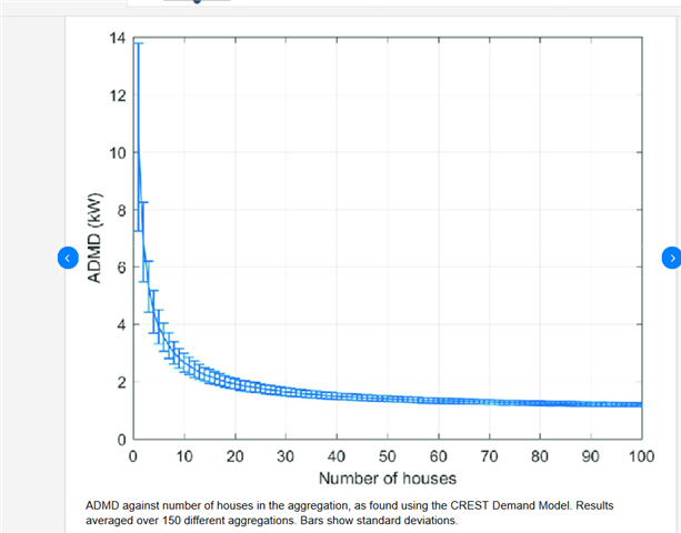

I'm looking at calculating a total diversified load for a small apartment block. Using Table A2 in the OSG i am able to get the majority of the diversity settings however does anyone know of any standard norms when it comes to diversity considering the amount of apartments. Say for example the total diversified load per apartment is 50A and there is 8 apartments. Technically you would need a 400A capable supply to feed these apartments however this doesn't take into account that not all apartments will be drawing their maximum load at any one time.
I have come across a french standard  NFC14-100 which gives correction factors depending on the amount of apartments you have. Estimation of actual maximum kVA demand - Electrical Installation Guide
Does anyone know of anything similar in British standards or standard norms used by the DNO for this?

    Indeed, and the corollary is also true, that BS7671 methodology is not really suitable or applicable to the design of large distribution networks supplying unsynchronised loads and at power levels where items like transformers and switchgear have thermal time constants of several hours; and a far more nuanced understanding is needed.
    It's not clear if the OPs query falls into that situation or not.
    The example above of the immersion heaters is amusing - the cheaper fix would have been to randomise the timer settings but it also highlights the problem of a coherent load step versus a random noise-like one (to borrow some terms from the signal processing folk) - and things that accidentally drive group behaviour, like a large group all getting home off the same train, or all staying up late to watch the same football match, tend to break the assumption of randomness , and can cause a very large peak-to-mean variation in demand. Its the difference between kids splashing about incoherently in the pool and synchronising their kicking to produce one big wave.
    The saving grace is that the peaks for cooking and so on are normally short compared to the thermal response time of the larger circuit elements like substations.
